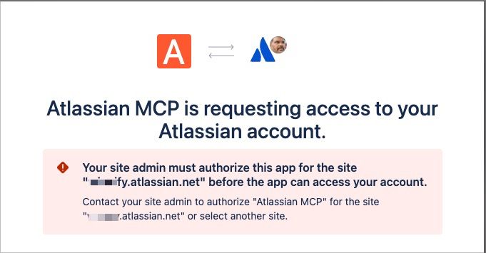

I m getting this message when I try to use it in our company. We are not able to find solution for it CleanShot 2025-06-18 at 10.51.23.jpg
Like Gnanesh K likes this
