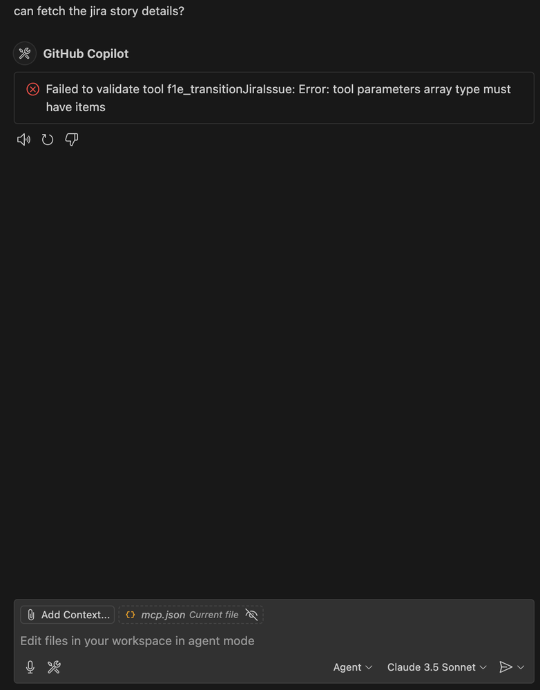

I was able to add the MCP server and list the tools, but when I used it to fetch the details for a particular JIRA story I got this error, please help to look into it.

Just a heads up to anyone else using VSCode - the insiders build includes native support for MCP server OAuth authentication, which means that you can add this MCP server without having to use mcp-remote.
I'm also seeing the transitionJiraIssue error and am working around it by disabling that specific tool, hoping for a fix for that one soon!

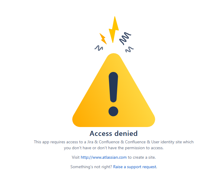

I keep getting this error, do I have to tell my account admin to do anything special to enable the MCP server?

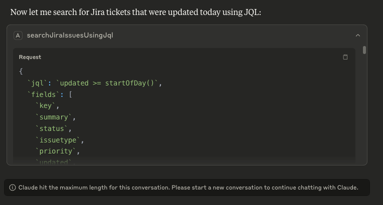

Has anyone managed to get past the Claude Desktop message "*Claude hit the maximum length for this conversation. Please start a new conversation to continue chatting with Claude*" that appears after just one new conversation with Atlassian MCP? It looks like MCP is logging too much (very verbose) into the chat, hitting the limit right away.
I'm on the Free plan, but I'm not sure that's the actual issue. I tried tweaking the prompts to direct Claude not to display MCP logs in the chat, but without success.Capture d’écran 2025-06-03 à 14.39.09.png

@Song Huang Did you ever figure out the "Something went wrong" issue? I'm getting the same error whenever I approve the oauth step.
Rob Lopez
June 3, 2025
I am seeing the same error as @Song Huang
Some more context is that it appears it is sending an authentication request in the network and I am getting a 400 response with
{"error":{"category":"failed-response"}}

Song Huang
June 4, 2025
@Jon Duenas @Rob Lopez The current workaround is ask our admin grant me a confluence license temporary, after the authorization is done can remove it . But `mcp-remote` doesn't support to refresh token automatically so far, so the authorization could be expired after days.

Rob Lopez
June 4, 2025
@Song Huang Thanks for the direction it was a similar issue!
@Jon Duenas  I had a similar solve in that I did not have compass access which caused a permissioning failure.  Adding compass to my account gave my access.
Solution: Had my Company Admin permission me for compass. I can now fully connect.

Alex_horton
June 5, 2025
I am seeing the same issue with "Accesss Denied". I asked my workplace admin to give me confluence admin access (I actually have no confluence access normally, and I do not need it). With confluence admin access, I could accept the connection and use the MCP.
It seems to me to be a scoping issue.
Please make it possible to scope the permissions of the MCP more. Even the ability just to turn on/off jira and confluence access would be a big improvement.

Jose Martinez June 5, 2025
We're running into the "Access Denied" issue as well.
This was working up until today. Comparing the scopes in the OAUTH page from the initial guide (specifically this) and the scopes I see today. It looks like `Compass` was recently added. I believe that is what is causing myself and my teammates to run into the "Access Denied" issue.
I agree w/ @Alex_horton - it would be great to toggle the scopes we want to grant.
Hoping for a quick fix - as this was one of my most used MCPs. I enjoyed the OAUTH part - which made it super easy to setup the MCP.

Tomas Rabczak
June 6, 2025
Can confirm this as we also did a test on our instance. A user without an associated Compass account got the error. We then enabled Compass for that user and the authorization started working.
