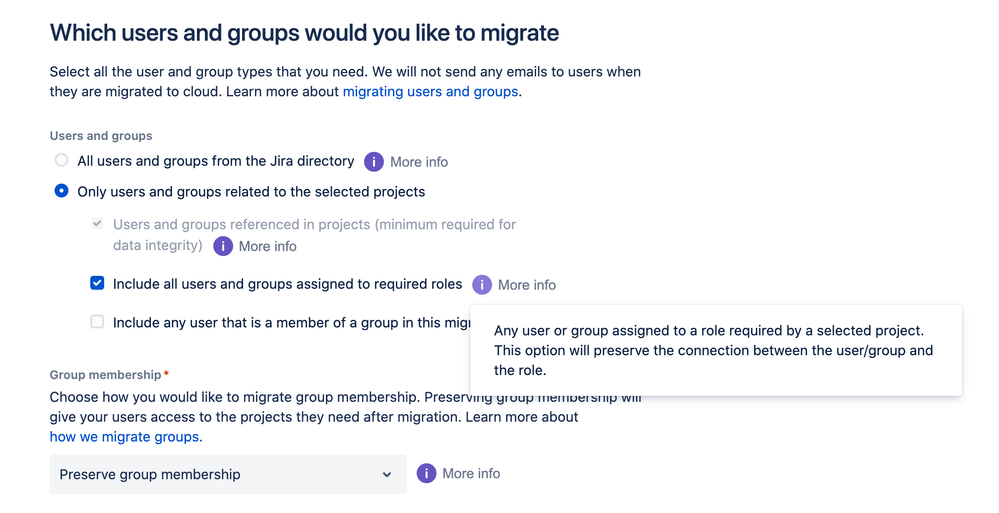

Ahh, just I found the issue that am actually facing.
Things I did:
Migrated the project successfully without any issue from on-prem to cloud.
While migrating, I supposed to provide below option in Users/Group to have required project roles to be transferred along with Users/Groups and preserved in destination Cloud.
Instead of the above, I've provided default option "Users and groups referenced in projects (minimum required for data integrity)", which migrates only project's users and group but not the project's roles.
So now I could able to migrate the project and navigate in cloud site without any problem.
