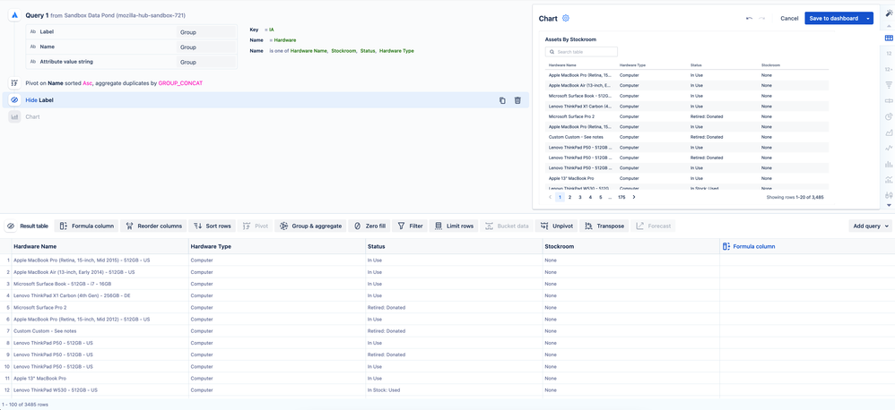

Hello Team,
I build a report based out of Assets metadata in the schema. Since the columns are pivoted meaning they are attribute values for a column "Name" i am unable to develop an aggregate formula based on the logical grouping.
See the attached report screenshot

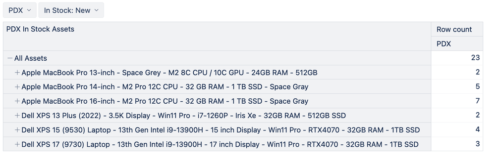

I want something like this where the Hardware Name(assets) are grouped by Hardware Type, Status and Stockroom. (PDX is the Stockroom example value and In Stock : New is the status and the associated count)

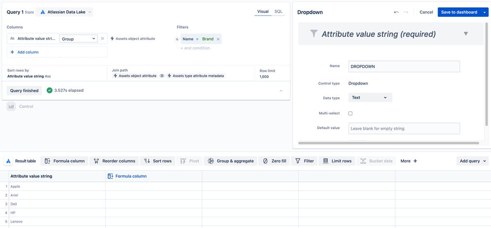

Also how to further add controls for "Stockroom"  and " Status" in the dashboard given these columns are attribute values.

If you would like to group by Stockroom, you can add a "Group & Aggregate" step and do a "Count of unique" aggregation for the Stockroom column. Can you give that a try and see if it generates what you're looking for?
Secondly, to add a control for an attribute value, you can add a dropdown control and select Switch to control editor to further customize the control.
From there, you can add the "Attribute value string" column to get the attribute values and then add the "Name" column from the "Assets type attribute metadata" table to filter it by attribute name.
