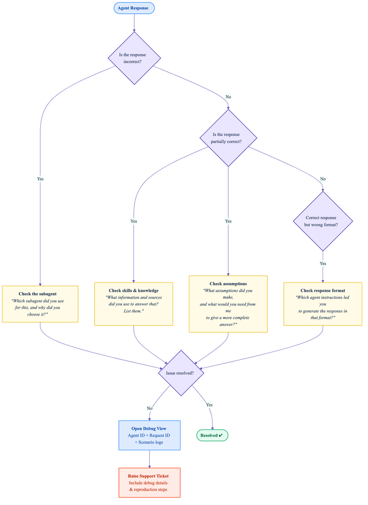

Example scenarios & prompts to try:
Scenario
Example prompt to the agent
The agent picked the wrong approach
"Which subagent or skill did you use for this, and why did you choose it?"
The answer looks wrong or may be only partially correct. You want to know why
"What information and sources did you use to answer that? List them."
The response feels incomplete
"What assumptions did you make, and what would you need from me to give a more complete answer?"
The agent sent correct response but the response format is unexpected.
“Which agent instructions led you to generate response in so&so format”?
or
” Which agent instructions stopped you from generating response in JSON format”?

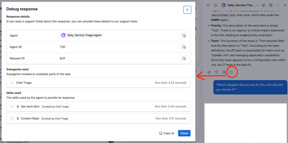

 📺 Use the built-in Debug view
Rovo Chat has a built-in Debug responses from Rovo agents feature that lets you peek "under the hood" of any agent reply.
What you'll see:
  • Subagents used — which skill/instruction set the agent used to answer.
  • Agent ID and Request ID — unique references for that response.
  • Skills used - List of skills used by the agent to provide a response.
Tip: The Debug button only appears on a message from a custom agent — not in a regular Rovo chat. If you don't see it, confirm you're chatting with a custom Rovo agent.

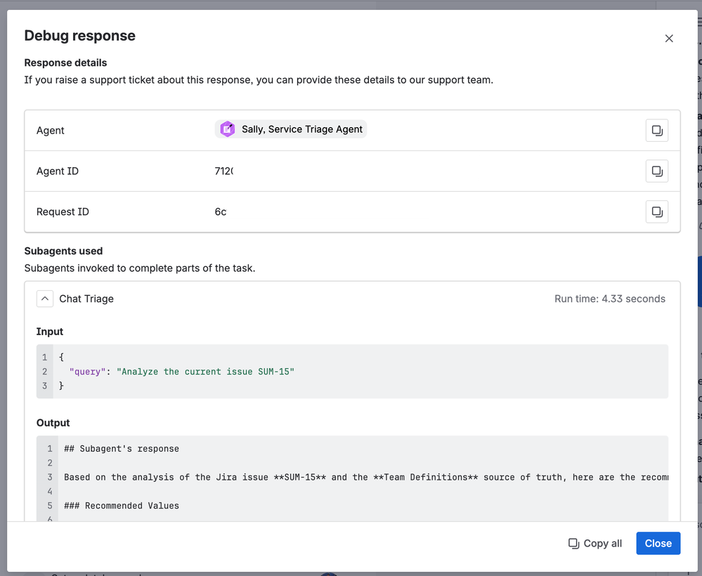

Expanding Subagents used tab:
Check which subagents the response used. The Input and Output tabs show the subagent query and its actual response. If the correct subagent triggered but the agent’s final output differs, this can explain why.
Compare the subagent output with the agent response to see the differences.

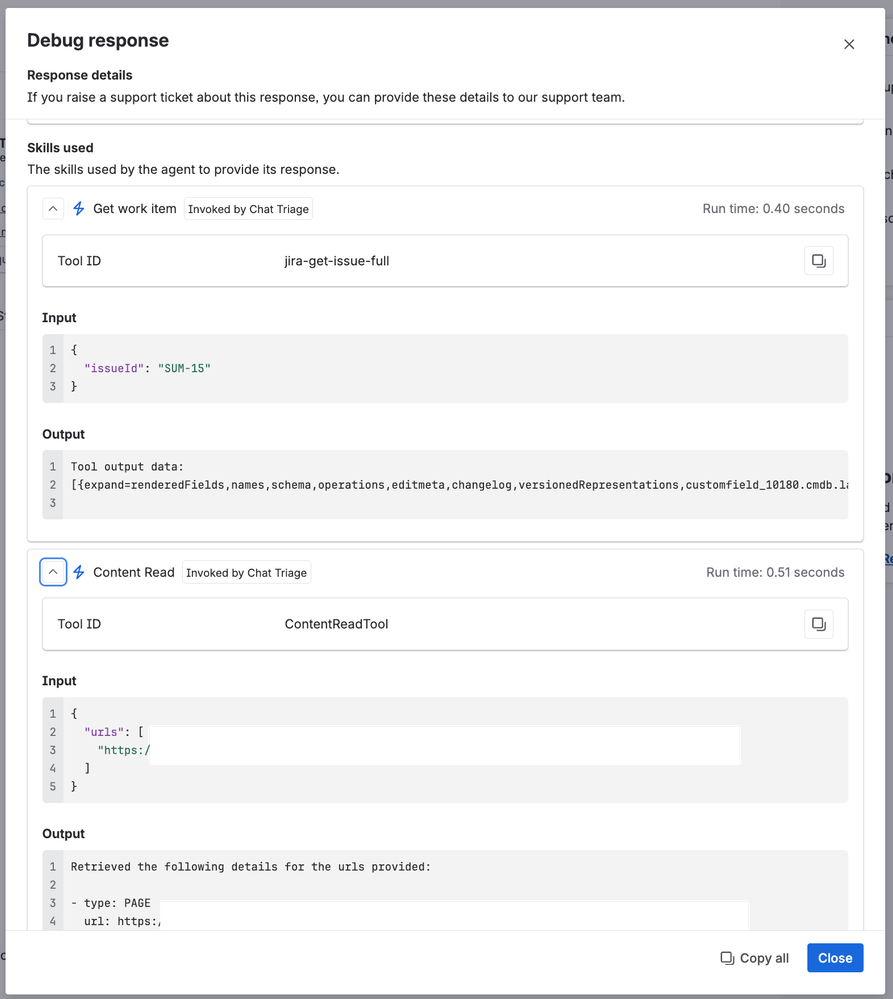

Expanding Skills used tab:
This tab lists the tools Rovo uses to generate responses, for example Get work item (Tool ID = jira-get-isssue-full) and Content Read (Tool ID = ContenReadTool). Users can pinpoint the exact skills used or missing, provide micro input for each skill, and view the corresponding outputs.
This view helps users determine whether the agent is unable to perform a task, or missing a specific micro detail.
🪜 Example Debug Flow
