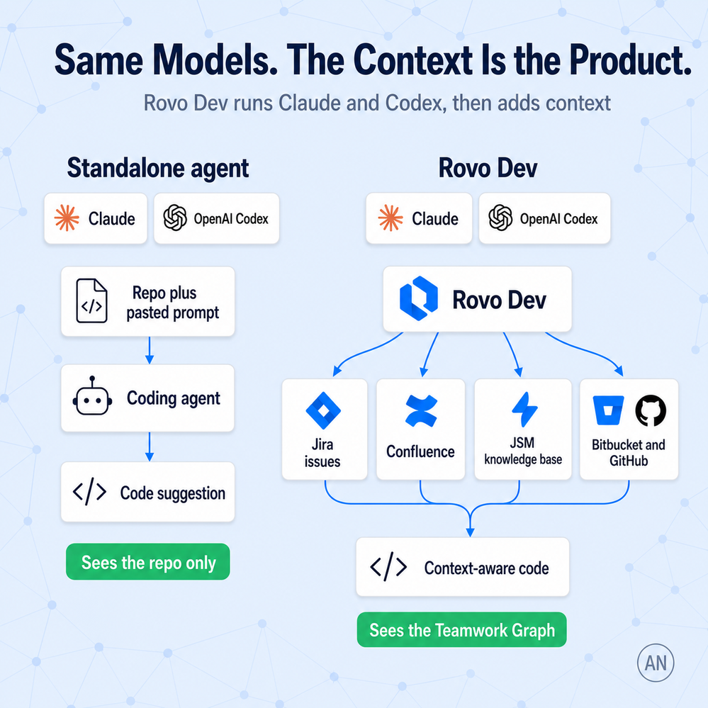

This article argues that the question is framed around the wrong variable. The comparison most teams run is model against model, and on that axis Rovo Dev is not really a competitor to the underlying models. It is the agent harness that runs on top of them, and you select which large language model it uses, today Anthropic Claude and OpenAI models. The variable that actually differs is the context the agent can reach, and that is where the decision should be made.
Why the model comparison is the wrong frame
The default way to evaluate a new AI coding tool is to benchmark its output quality against the tool you already use. For Rovo Dev that benchmark is close to circular, because Rovo Dev is its own agent harness and lets you switch the underlying model inside the CLI or IDE with the /models command. Today that set includes Anthropic Claude models (Haiku, Sonnet, Opus) and OpenAI models (GPT-5.x and the GPT-5.x-Codex variants). To be precise, Codex here means the OpenAI GPT Codex model, not OpenAI's separate Codex CLI. You get access to multiple leading models without managing a separate subscription for each one, and the available set expands over time.
There is one nuance here that is easy to miss. The model choice is most explicit in the Rovo Dev CLI, where you control which supported model runs. For hosted code review in Bitbucket and GitHub, Atlassian manages model selection and orchestration for you, so you do not tune prompts or pipelines per provider. Full "bring your own model" for hosted code review is not supported today.
So if you put Rovo Dev's raw generation quality next to a standalone Claude or Codex agent, you are largely comparing the same engines. The model is not the differentiator.
What you actually buy is the Teamwork Graph context layer
The thing that is genuinely different is what the model is allowed to see before it reasons. A standalone coding agent starts from your repository and whatever you paste into the prompt. Rovo Dev starts wider.
Through Atlassian's Teamwork Graph, Rovo Dev can draw on context from your Jira issues, Confluence pages, support tickets, and your Jira Service Management knowledge base, alongside your Bitbucket or GitHub repositories. Atlassian describes the Teamwork Graph as the data intelligence layer of the Atlassian Cloud Platform, a unified data model that maps the relationships between work, knowledge, people, and goals across Atlassian and connected third-party tools.
That positioning matters for how you read the product. Atlassian is not betting on a proprietary LLM that out-reasons the frontier labs. It is pairing frontier models it does not own with a context graph that it does own. The defensible asset is the graph, not the model. When you adopt Rovo Dev, the graph is the part you are actually buying.
How the context shows up in practice
The clearest concrete example is acceptance-criteria review. When a pull request is linked to a Jira issue (by putting the issue key in the PR title or a commit message), Rovo Dev can read the issue summary, description, and common acceptance-criteria fields, then review the code change against what the issue says it is supposed to deliver. A standalone agent with no link to your tracker cannot do that unless you paste the requirements in by hand every time.
The same context awareness extends across the developer journey, from generating code in the CLI or IDE to reviewing pull requests, debugging build failures in Bitbucket Pipelines, and kicking off agentic workflows from Jira. In each case the differentiator is not how the model writes a function, it is whether the model already knows why the function exists.

"Rovo Dev runs Claude and Codex"
I'm very sensitive to ambiguity, and this is very much an ambiguous statement. "Codex" (currently) specifically means OpenAI's particular coding agent.  "Claude" by itself would generally mean the chat front-end, as opposed to Claude Code, or Claude Cowork front-ends.  Or it can also be used generically for any of the Anthropic Claude LLMS:  Haiku, Sonnet, or Opus.
So does this mean Rovo Dev runs Claude Code and Codex?  Does it mean a user can choose between Claude Code vs Codex?
Or does it mean Rovo Dev uses (at its discretion) both Claude LLM and the Codex agentic coding harness ?  Even that seems questionable, because it seems that Rovo Dev is its own agent harness.
And if Rovo Dev is an agent harness on it's own, then why/how would it employ a different one such as Codex?  Don't you mean instead that Rovo Dev uses both Claude and OpenAI LLMs?
I can't find anything in the Rovo Dev product info with any specifics.  Which seems typical of all things Rovo. Atlassian is generally quite opaque about what they do in the background - which providers they use, when, and for what purposes.

fair callout, and you are right. The wording was looser than it should have been.
Rovo Dev is its own agent harness. It does not run Claude Code or the Codex CLI. What you choose is the underlying LLM via the /models command in the CLI or IDE, today Anthropic Claude (Haiku, Sonnet, Opus) and OpenAI (GPT-5.x and the GPT-5.x-Codex variants). So your reading is correct. It uses both Anthropic and OpenAI models, and "Codex" in that list means the GPT Codex model, not OpenAI's Codex CLI harness. I have tighten that lines in the article so it stops being ambiguous.
