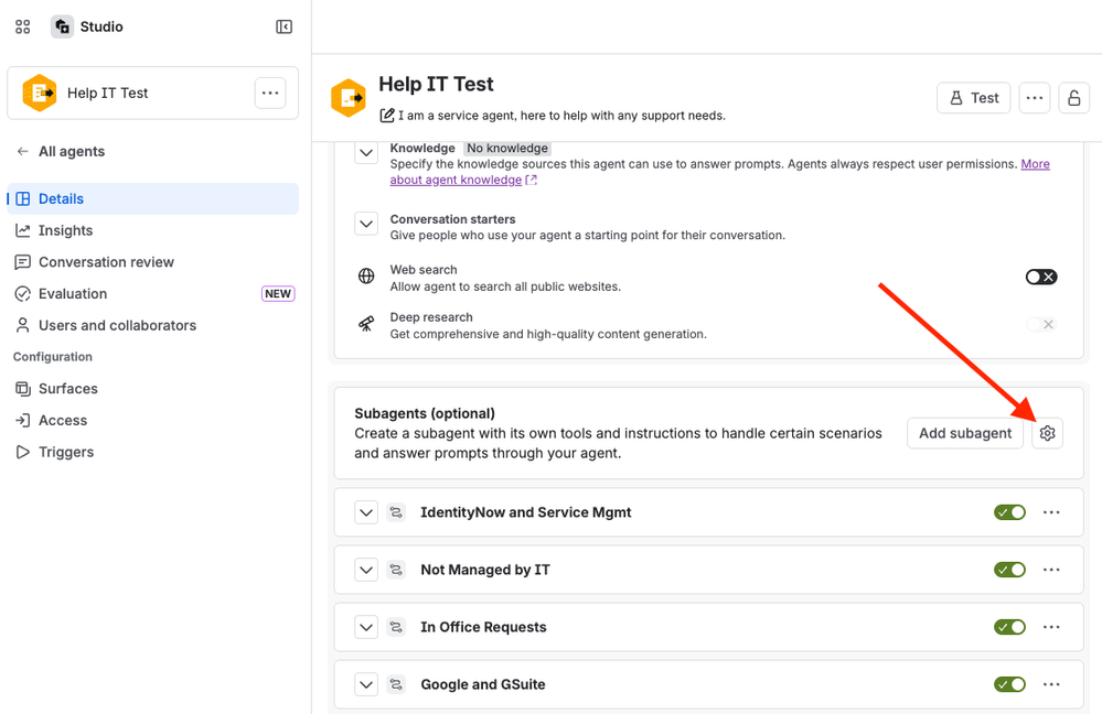

Hi agent builders!
We’re adding a new way to control how agents with subagents respond to users.
When your agent uses a subagent, you can now choose whether the main agent should combine the subagent’s output into a final response, or whether the subagent’s answer should be forwarded to the user as-is.
This gives you more control over who owns the final response, especially when different parts of your agent are designed to behave like distinct specialists.
What's changing?
Subagents are task-focused helpers that can have their own instructions, knowledge, tools, and routing description. They are useful when your agent needs to handle distinct jobs that benefit from specialised guidance.
By default, when a subagent is selected, it returns an output to the main agent. The main agent then uses that output to write the final user-facing response.
This flow covers most complex use cases and remains the default setting, especially when the main agent needs to orchestrate multi-step workflows, combine outputs from multiple specialists, and keep one consistent voice.
For some use cases, the subagent is the specialist that should answer directly. For example, when it has a specific response format, tone, support workflow, or set of instructions that should be preserved in the final answer.
With this update, builders have more flexibility to configure how their agent handles subagent responses.

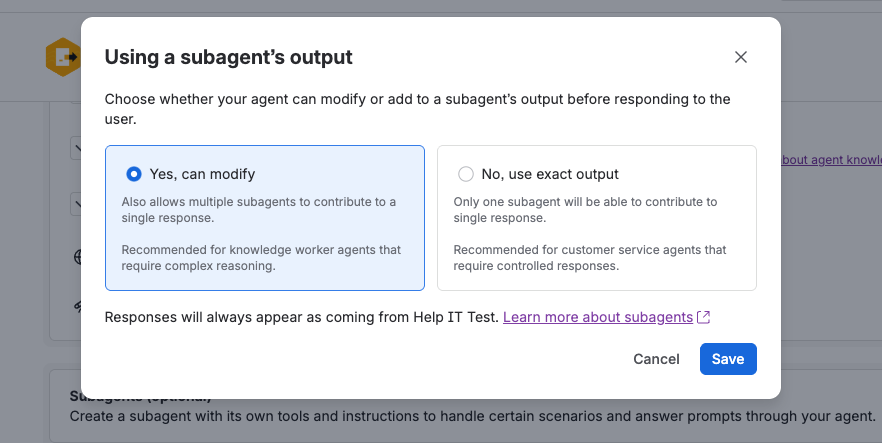

Choose how your agent handles subagent responses

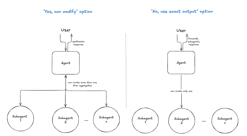

There are two options:
Combine subagent outputs to generate the final response
The subagent returns its result to the main agent, and the main agent writes the final response.
Use this when the main agent should act as the orchestrator. For example, this works well when your agent needs to:
  • Compare options from different sources
  • Summarise findings from one or more specialists
  • Combine product guidance, policy guidance, and user context into one answer
  • Keep one consistent voice across the whole conversation
Forward the subagent’s output as-is
The subagent owns the user-facing response, and its answer is sent directly to the user.
Use this when the subagent is the right specialist to answer directly. This is especially useful when each domain has a distinct way of handling requests, such as:
  • A support specialist that follows a specific troubleshooting flow
  • A service-focused subagent that needs to use a particular tone, format, or escalation path
  • A formatter that must return a precise structure
  • A policy or refusal specialist whose wording should be preserved
In this mode, the main agent can route the request to the right specialist, then let that specialist take over the final answer.
Note:
  • Response configuration does not change tool or skill access. Subagents do not inherit tools, skills, knowledge, or instructions from the main agent. If a subagent needs a specific tool or skill, add it to that subagent directly.
  • Only one subagent can be selected per turn in this setting, to avoid multiple subagents responding at the same time.

Very useful feature, thank you @Long Nguyen , it's somewhat we has been tried to achieved via the prompt instruction in the main agent to keep the output format from Subagent.
Also super thank you again for the diagram about the conversation flow difference between 2 designs. Can I ask some follow-up questions:

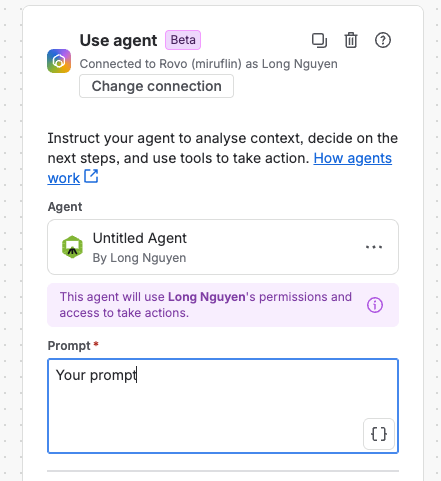

- Apart from the providing instructions via subagent trigger (with the keywords to trigger it). Is there other ways we can influence the agent to invoke that specific subagent in certain scenarios (such as in specific automation rule)?
Long Nguyen
June 14, 2026
Hi @Quang Kieu apologies for late reply, great questions
1. There's currently a limit of 100 subagents you can create per agent. However, as you already know the more subagents added, the more LLM context is consumed and might lead to lower response quality. There's no specific number of recommendation, as different models might have different context length so the same number of subagents (and other tools) might consume different % of context.
So I'd suggest start small, for example, under 5 subagents. And for each new subagent you plan to add, run your evaluations to gauge the impact.
2. Currently no other mechanism to influence subagent selection, other than what you already have: the main agent instruction, user's query, subagent trigger. If you use agents in automation, there's a prompt text box, that could also be where you influence the subagent selection (e.g "Always invoke subagent A")
