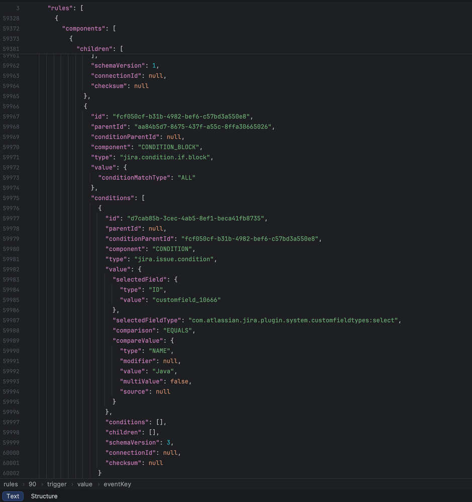

They ask the only person who can explain it: the platform admin. He opens the rule tree, mentally decodes customfield_10666 into "Change Object Type," resolves status 10461 to "Active" walks three nested conditional branches, and ten minutes later has an answer.
Multiply that by 61 active automation rules, 242 conditional branches, and a team that uses Jira every day — and you've got a quiet but real support burden sitting on one person's shoulders.

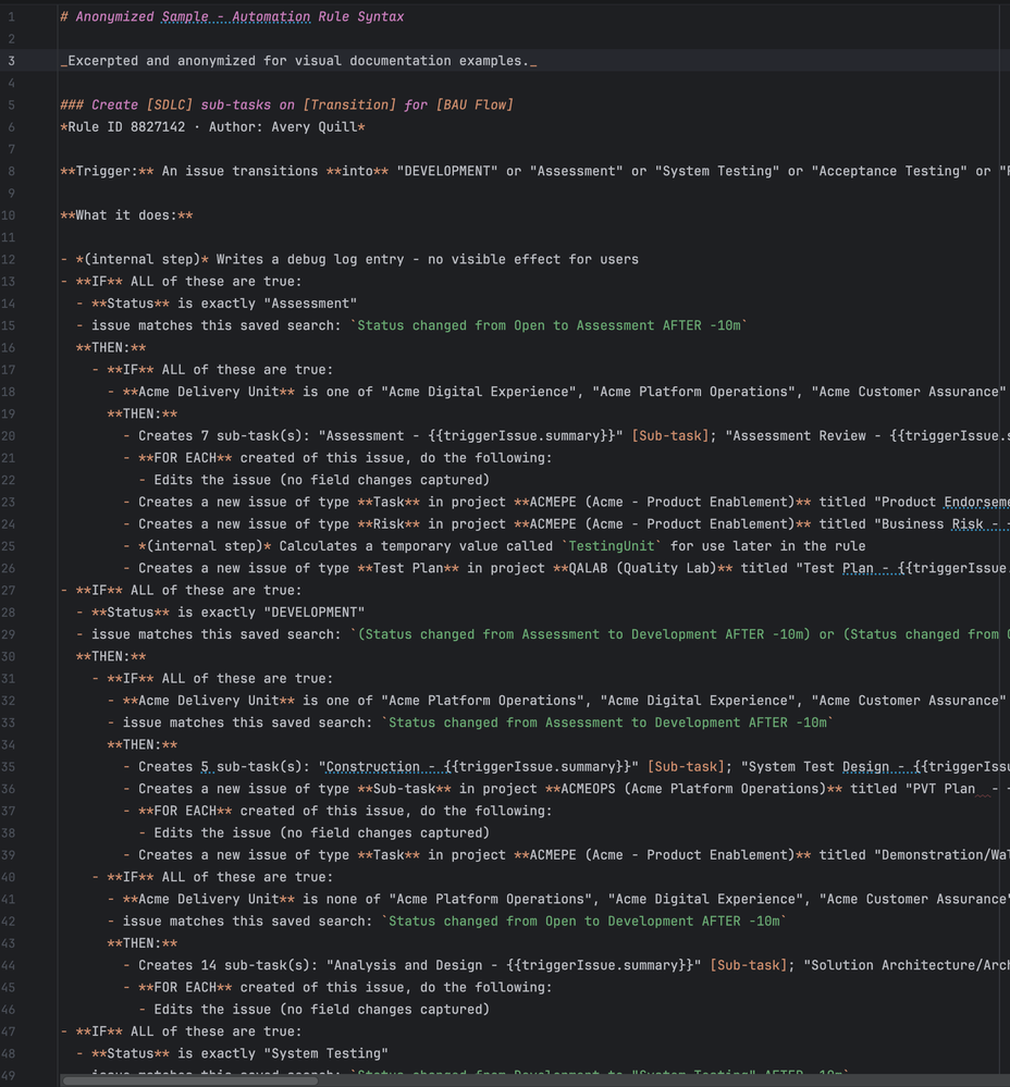

Lookup tables first. Each reference export collapses to a dictionary: project ID → name, account ID → display name, customfield_* → field label, status ID → status name. There's also a hardcoded map for the ~18 system fields Jira doesn't include in the field export. Every raw ID in the rules gets resolved before a single sentence is written.
Recursive renderers second. The rule tree — triggers, conditions, branches, actions — gets walked and mapped to readable sentences. CONDITION_BLOCK becomes **IF** all of these are true: ... **THEN:**. A plain CONDITION becomes Only continues if ... — a hard gate that stops the rule dead. A BRANCH becomes **FOR EACH** ..., with nesting depth carried by indentation. Actions get their own renderer per type: edit field, create issue, create sub-task, transition, send email, link issue (using the link type's own inward/outward phrase, so it reads "this issue blocks it" rather than a raw ID).
Validation before anything ships. The script exits non-zero if it finds the word "unrecognised" anywhere in the output (a component type with no renderer), an empty value after a → arrow, or a leaked raw JSON array. A healthy run prints Validation: PASS. If it doesn't, nothing gets published.
That last one is the one that saves you at 11pm.

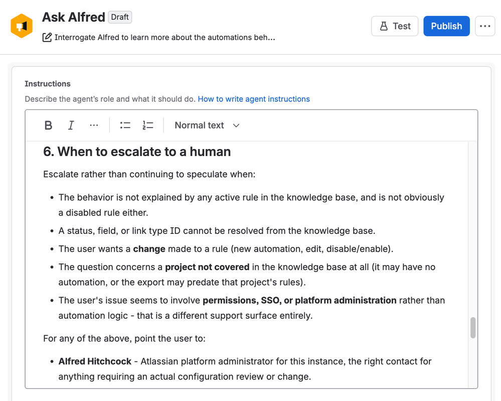

Every resolved value in the knowledge base carries an inline confidence marker. Status names confirmed against the Jira export say (confirmed via the Jira status export). The one status ID that doesn't appear in the export — a since-retired status referenced by an old rule — says (inferred from this rule's own name). The "Known Limitations" section of the knowledge base auto-updates to name any affected IDs.
The agent instructions then bind the agent to that same distinction. It's instructed to preserve the confirmed/inferred language when it answers, and to say "I can't confirm that" rather than guess.
The chain is: the generator knows its own confidence → it writes that confidence into the knowledge → the agent is instructed to preserve it when it answers.

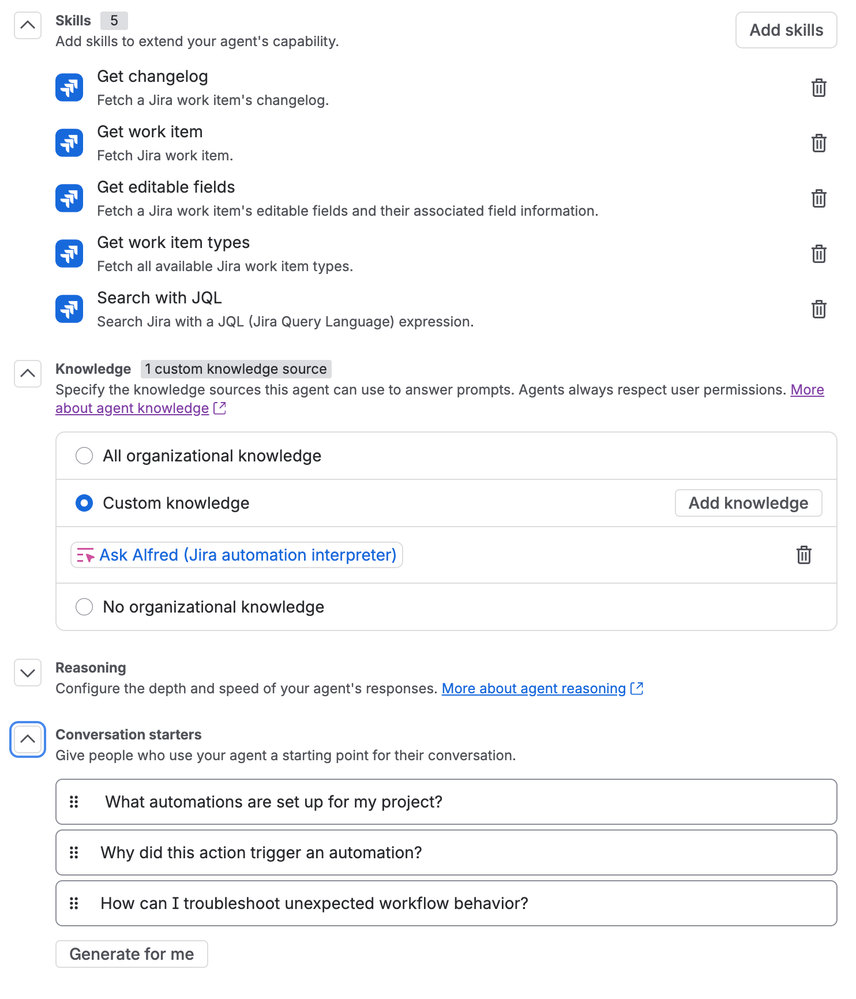

In the Rovo agent builder, the knowledge section is set to Custom knowledge with a single source attached: a Confluence knowledge base named Ask Alfred (Jira automation interpreter). That's the 192 KB plain-English translation file — the one the script generates. No other organisational knowledge is enabled. The agent knows exactly one thing, and it knows it well.
Five Jira skills are also enabled — Get changelog, Get work item, Get editable fields, Get work item types, and Search with JQL — so the agent can look up live issue state when it needs to, rather than reasoning purely from the static knowledge base. The knowledge base explains the rules; the skills let it check the facts.
Three conversation starters are configured to give users a foothold:
  • What automations are set up for my project?
  • Why did this action trigger an automation?
  • How can I troubleshoot unexpected workflow behavior?
They're intentionally broad. The goal isn't to anticipate every question — it's to signal the shape of what the agent can do, so users don't open it and stare at a blank prompt.
I’ve since used Ask Alfred on several questions, related to automation behaviour, submitted by end users via JSM support. Each time, Ask Alfred has accurately pinpointed the likely issue and recommended a correct solution or a sensible extension to the existing automation — turning it from an interesting proof of concept into a genuinely useful first stop for support.
