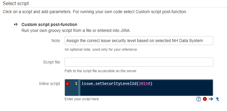

Alejandro Chavarria
October 9, 2017
There is no option to run under the context of a specific user, so I assume the post function will run under the current user's context (see attached screenshot to see what it looks like to define this workflow post function).
Also, I tested this as an administrator (full project permissions) and still no luck. I'm completely at a loss. Any help is very much appreciatedCapture.PNG
