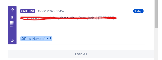

I read it and tried, but i need the parameter inside the issue:
The flow_number for example
Florian Bonniec
August 7, 2024
Have you try to get the issue itself and the field manual Test step ?
https://developer.atlassian.com/cloud/jira/software/rest/api-group-issue/#api-rest-agile-1-0-issue-issueidorkey-get
DINA GENEZIA
August 7, 2024
yes :(
Step data in Jira cloud stored in the xray cloud, and not in the Jira
I tried to get it from graphql api, but I don't see there the param-data I need :(
I thought there is maybe another way.
