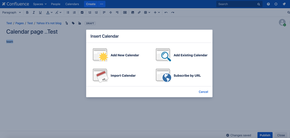

Hi @Manoj Bajpai ,
You should be able to add the Team Calendar in the Confluence pages by searching for the macro, please find the below screenshot for reference.

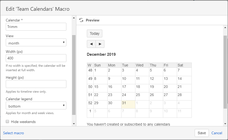

I am also having issues displaying the calendar on a page.
I am using the Team Calendar Macro and have filled out everything correctly (as far as I can tell). Here's a screenshot of the macro with the information filled out:
As you can see, it generates a preview; however, I have populated at least a years worth of events that it doesn't display (I have several occurring over the next 30 days).
I have tried different calendar names as well as the calendar id and nothing that I have tried seems to help. It's almost as if Confluence doesn't know that I have installed the free trial of the Team Calendar and that there is data there to be pulled in.
Any assistance would be greatly appreciated.

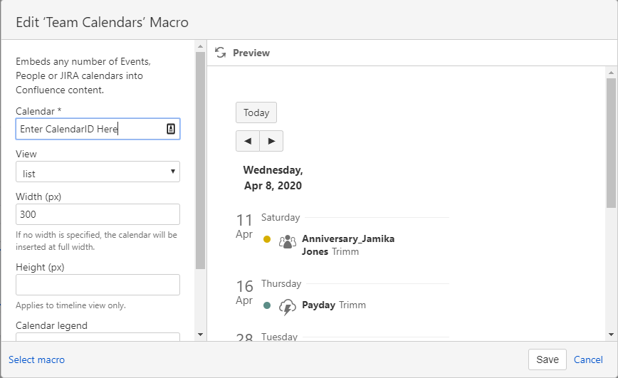

Good Morning @Abear_Awadallah !
Please see the screenshot below:
I'm not sure what you're referencing with search results, but I had success with entering the CalendarID in the Calendar field for the Calendar Control.
Hope this helps you out!

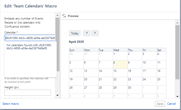

Abear_Awadallah
April 8, 2020
Good Morning @Matthew Buchanan ,
Thank you for your response ! Unfortunately, no luck for me still. It is not able to locate the calendar even though it exists within my space. That is what shows up when I search for the Calendar ID. But thank you for your help!C1.PNG
