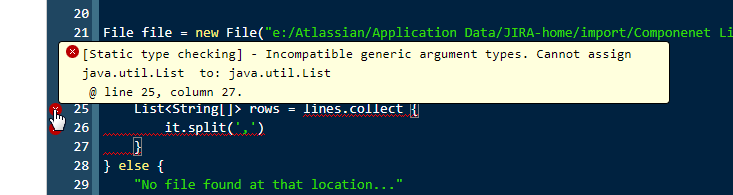

One small Problem Stephen... She's a not working! What is it we're doing wrong?

Hey Joel,
Does the script work if you try to run it? Your getting a static type checking error, but the script may still work. If the script fails to run, what is the error message from the script output?
Joel
March 14, 2019
I couldn't get it to run with the same code so instead I just iterated through it with a for. I had to do as such anyways since what I'm doing is importing a series of Project Components via a csv file.
