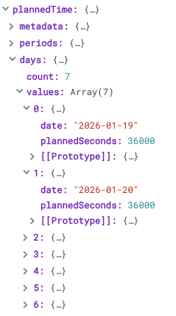

plannedTime shows (correctly) that there are 7 days within this interval, yet it says there are 36000 seconds in each working day (mon-fri) and 0 seconds in the weekend (sat-sun):
This seems wrong. There should be only 18000 seconds per day.
periods is showing wrong data, too:
For the indicated period (Jan 19 through Jan 25) there should be only 90000 seconds planned.
Am I using the Tempo API wrong?
