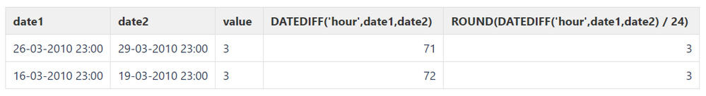

Meanwhile, we've also found a location where we could check the behavior of the DATEDIFF function during the winter/summer time shift and got the same result as yours (I'll leave it here for other users if they have the same issue):
SELECT *,
DATEDIFF(hour, 'date1', 'date2'),
ROUND(DATEDIFF(hour, 'date1', 'date2')/24)
FROM T*
So, the ROUND(DATEDIFF(hour, 'date1', 'date2')/24) is indeed a correct solution.
