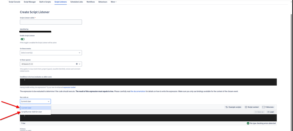

Ram Kumar Aravindakshan _Adaptavist_
June 28, 2026
Hi @Jeffrey Bistrong
Adding to what @Matt Doar _Adaptavist_  mentioned in Jira Cloud for Listeners, you can select which user can execute the Listener.
If, let's say for example, you want a user with limited access to trigger the Listener, you can change the executing user from Current User to ScriptRunner.
