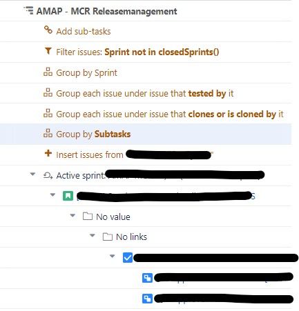

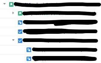

Hello,
so I want to see following hierarchy in my automated Structure:
Sprint
  • Story 1
    • clones: Story 2
      • Story 2 subtask 1
    • Story 1 subtask 1
    • tested by: Task 1 (Sprint value)
      • Task 1 subtask 1
      • Task 1 subtask 2
This view works if I use a story as insert and build it with extenders top down.
>> However, my sprints are planned on the Task level. Therefore I need to build the hierarchy the other way around, starting with the task so that I can use the group by sprint function.
>> I know I have to use the group function instead of the extend function and it works to get the "tested by" Story, but I cannot get the subtasks & the "clones" link to show up correctly.
What I tried, but failed:
 A Subtask extender > the extender only works for the "Task 1 subtask" but does not work for e.g Story 2 subtask 1.
A group by Subtask (with consider other groups on, level 3) but this does not work either.
I'm also unsure when the "consider other groups" needs to be off or on...

Patrizia Heinzl
April 22, 2024
Hello. Thank you very much for the idea.
Unfortunately I was not able to make it work. It shows the subtasks correctly now, but I just have one long list with all items separate.
As soon as I use the "group by" linked issues, all subtasks disappear again.
