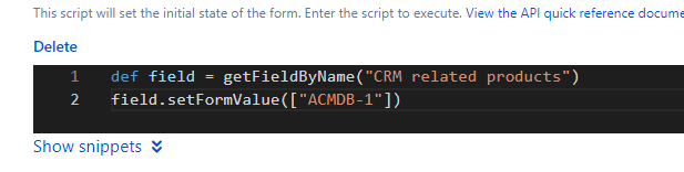

The script is basic, I'm just trying to manually set an option via its label:
def field = getFieldByName("CRM related products")
field.setFormValue(["Catalyst"])

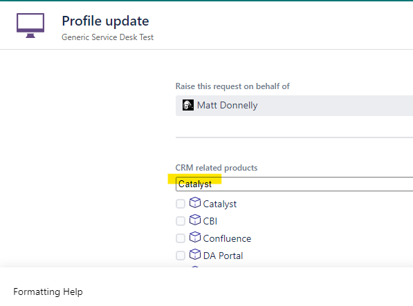

When the screen renders, there's a brief flash of the string "Catalyst" in a select field, which disappears, but then the select field checklist items render. I checked that field element in the inspector, and it was set to display: none. Unhiding it showed me the passed value:

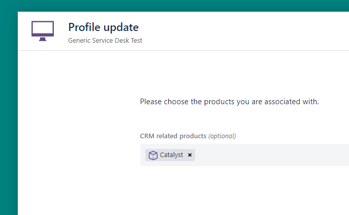

1. I set up a Behavior with the following code. Note that the value "ACMDB-1" has the Label "Catalyst" in Assets:

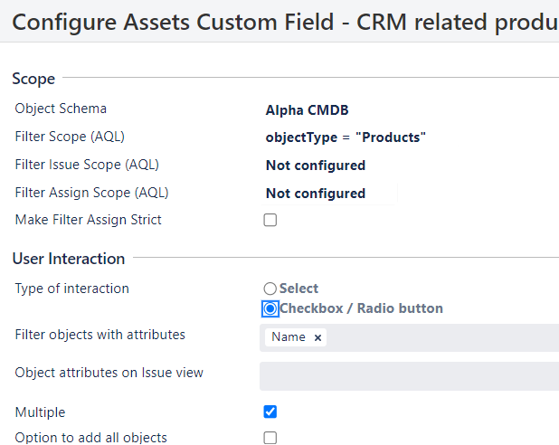

2. I created an Assets Custom Field with the following configuration (Select & Multiple):
3. The default is populated correctly when the Request screen is initialized:

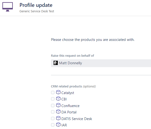

4. However, if I change the Assets custom field configuration to Checkbox...
5. The "Catalyst" checkbox is not checked:
