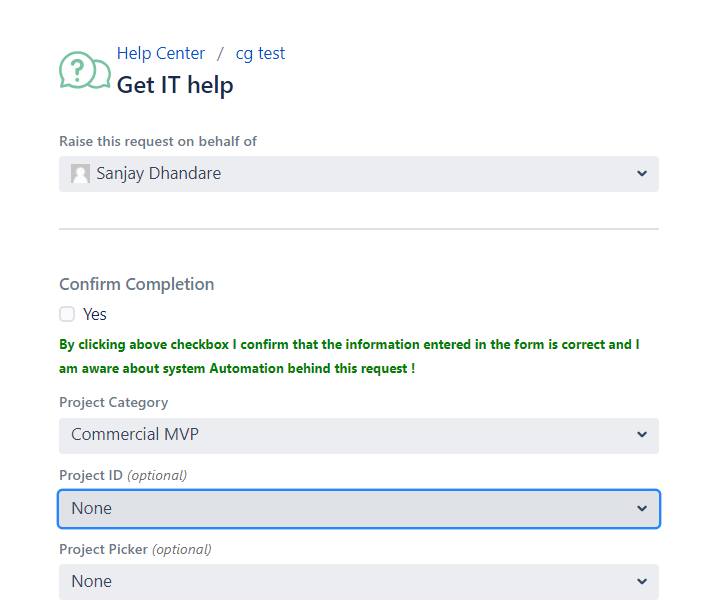

Hi Team,
I have written a script where if user select category in Category field then project related to selected category will appear in Project field and then user can select any proect as a options from it.
I have used SetFieldOptions to Project field but even though providing and selecting options the field returning null and hence ticket is not getting created.
Here is the behaviour code for it :

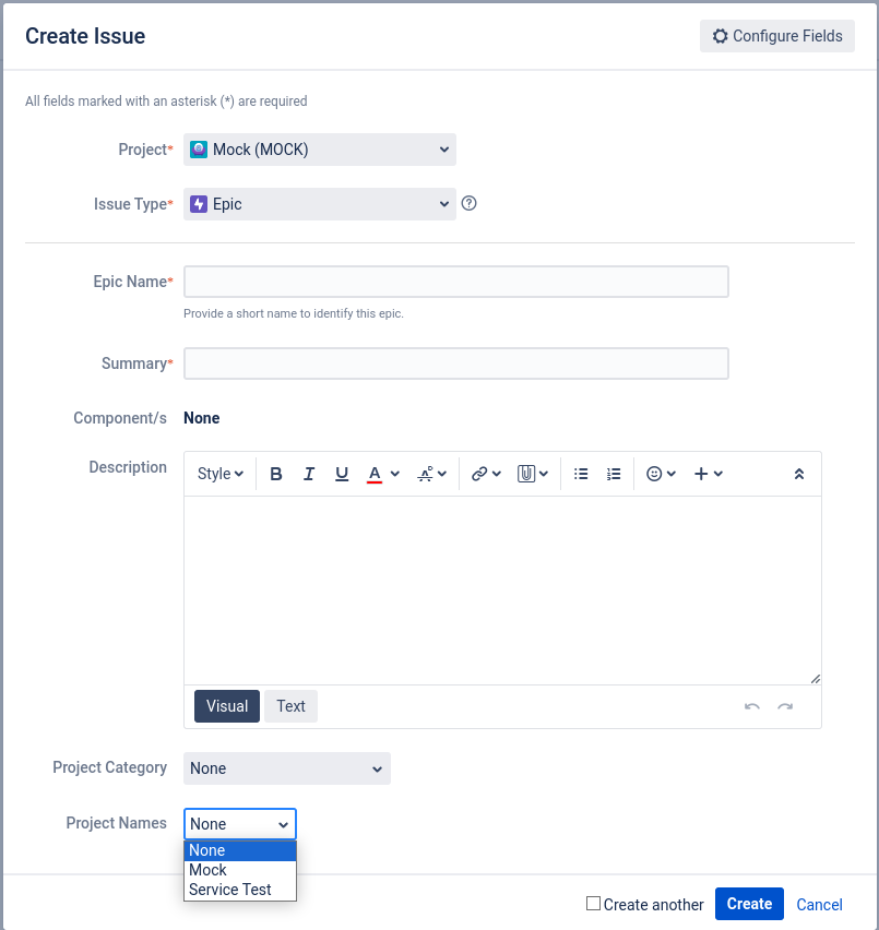

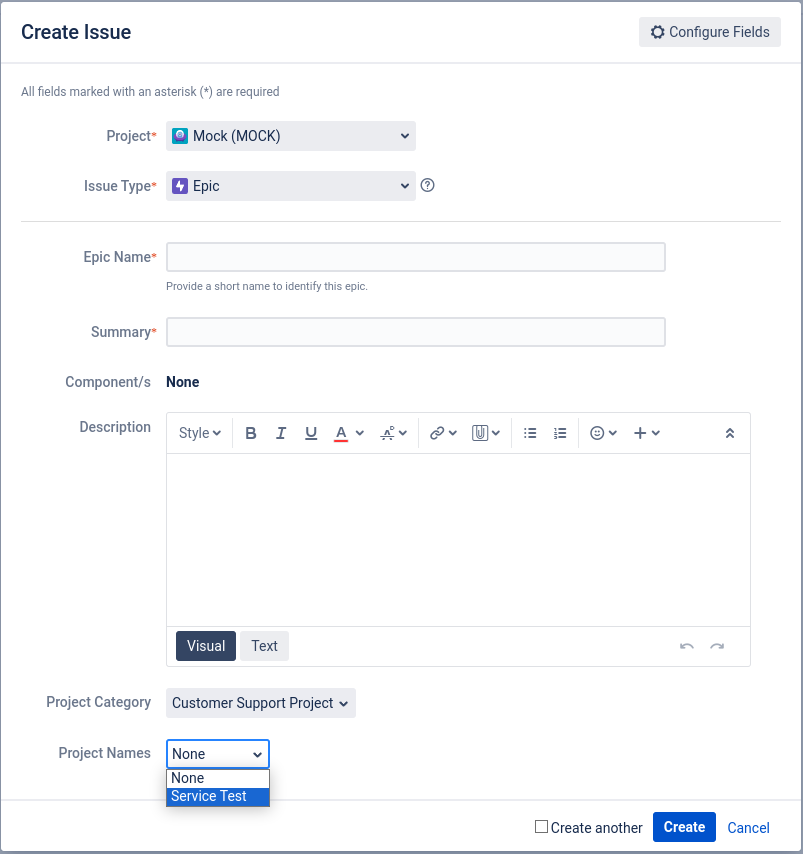

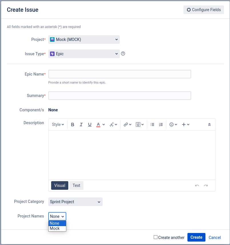

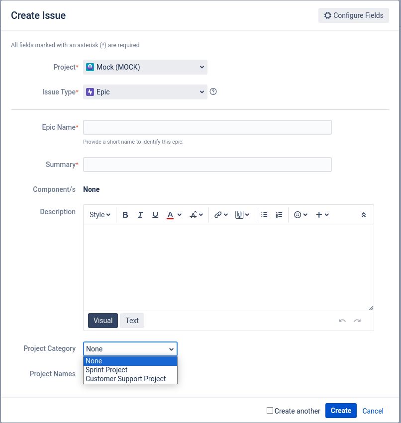

Below are a couple of test screenshots for your reference:-
1. In the first 2 screenshots below, when no option is selected from the Project Category list, as shown in the 1st screenshot, all options from the Project Names list are accessible, as shown in the 2nd screenshot.
2. If Sprint Project is selected from the Project Category list, only the Mock option is available in the Project Names list.
3. Similarly, if the Custom Support Project option is selected from the Project Category list, only the Service Test option is available in the Project Names list.
