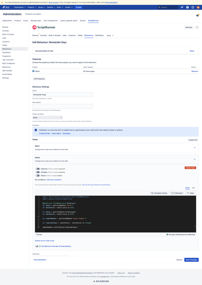

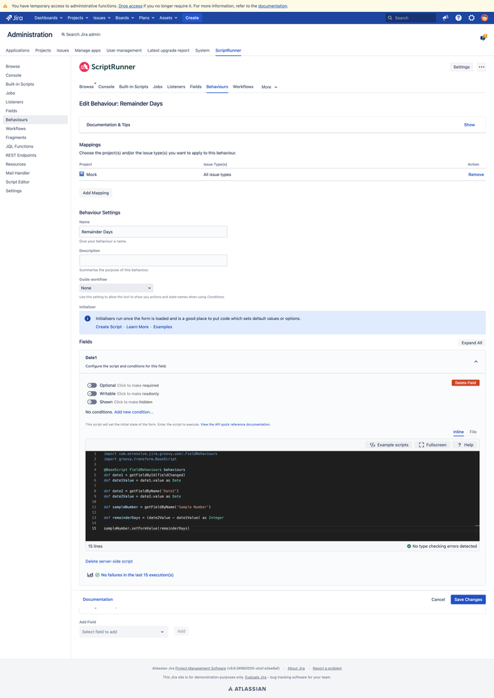

Below is a screenshot of the Behaviour configuration for the 1st Date field:-
and below is a screenshot of the Server-Side Behaviour configuration for the 2nd Date field.
Both these Server-Side Behaviour configurations are required to trigger the remainder date calculation if any of the Date fields' values are updated.
