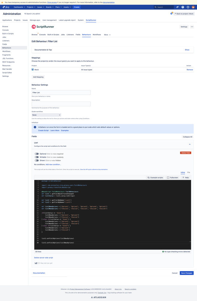

Below is a screenshot of the Server-Side Behaviour configuration:-
In the example code above, the Server-Side Behaviour is configured for List1. In your case, you must configure a Server-Side Behaviour for the Leve 1 field.
Also, please note, when configuring a Server-Side Behaviour, the field the Server-Side Behaviour is added for must be declared as:-
def leve1Field = getFieldById(fieldChanged)
The fieldChanged option must be used to ensure that the Behaviour correctly detects when a change has been made to a particular field and triggers the Behaviour accordingly.

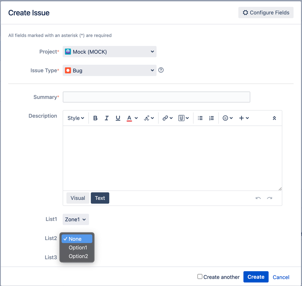

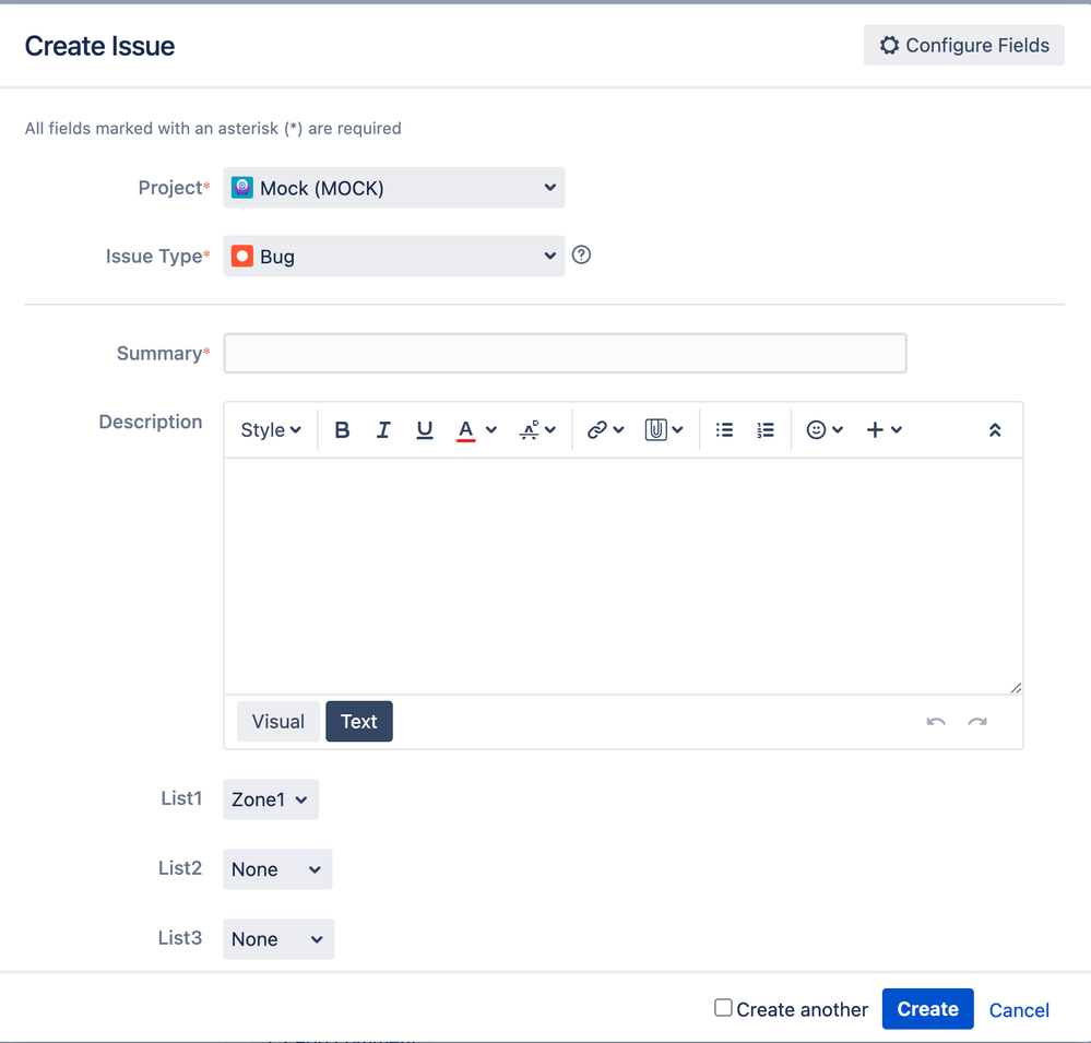

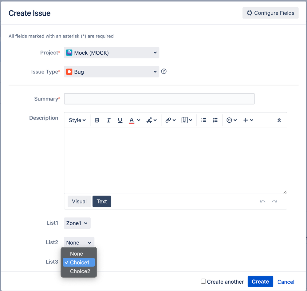

I am also including a couple of test screenshots for your reference:-
1. On the create screen, when an option is selected from List1 as shown in the screenshot below, the options in List2 and List3 are also filtered accordingly in the following screenshots
I hope this helps to solve your question. :-)

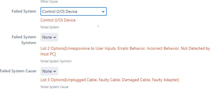

carlos andrade
May 13, 2024
Thanks for replying, Ram. I am still having the same problem. It looks like the code is working as it's supposed to, but the new lists are not being displayed.  Here is your script with my modifications:
import com.onresolve.jira.groovy.user.FieldBehaviours
import groovy.transform.BaseScript
@BaseScript FieldBehaviours fieldBehaviours
def list1 = getFieldById(fieldChanged)
def list1Value = list1.value.toString()
def list2 = getFieldByName('Failed System Symtom')
def list3 = getFieldByName('Failed System Cause')
def list2NewOptions = ['Option1', 'Option2', 'Option3', 'Option4']
def list3NewOptions = ['Choice1', 'Choice2', 'Choice3', 'Choice4']
if(list1Value == 'Control (I/O) Device') {
    list1.setHelpText("Control (I/O) Device")
    list2NewOptions = ['Unresponsive to User Inputs', 'Erratic Behavior','Incorrect Behavior','Not Detected by Host PC']
    list3NewOptions = ['Unplugged Cable', 'Faulty Cable','Damaged Cable','Faulty Adapter']
} else if(list1Value == 'Video') {
    list1.setHelpText("Video")
    list2NewOptions = ['No Video Signal', 'Intermittent Video','Incorrect Resolution','Video Signal Present - No Image']
} else if(list1Value == "Computer / Network Switch") {
    list1.setHelpText("Computer / Network Switch")
    list2NewOptions = ['Fails To Power On','Fails To Boot','Slow To Boot','Fails POST']
    list3NewOptions = ['Faulty Drive','Faulty Motherboard','Failed Memory','Faulty Power Supply']
} else {
        list1.setHelpText("No Zone" + list1Value)
list2.setFieldOptions(list2NewOptions)
list2.setHelpText("List 2 Options" + list2NewOptions)
list3.setFieldOptions(list3NewOptions)
list3.setHelpText("List 3 Options" + list3NewOptions)
Like • Dave Rosenlund _Trundl_ likes this
