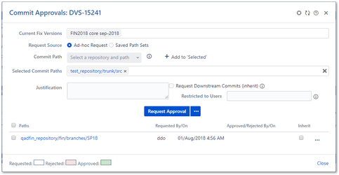

Here is what that dialog looks like:
This has dropdown and popups and user preferences and type-ahead select2 drop-downs. We use it in conjunction with our subversion pre-commit hooks to control if commits using a certain Jira ticket should be allowed or not. Devs must request approval before attempting to commit and Release Managers must approve those requests. This is only during the release period while we're in code freeze mode.
So can it be done? Sure.
Should you? That depends on you. I certainly enjoyed my learning and I'm proud of what I achieved.
