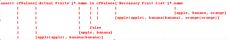

Example assertion below:

So this is happening because you are using some concepts that aren't in groovy.
Your line:
cfValues['Actual Fruits']*.name.contains(cfValues['Necessary Fruit List']*.name
Is using contains, which implies that the left part of the operator should contain at least the totality right part of the operator.
However, you want that the left part of the operator, contains at least, an element of the subset that is your right part operator.
In order to do that, you need to use the operator in like so:
cfValues['Actual Fruits']*.name in cfValues['Necessary Fruit List']*.name
Hope this helped, if you need anymore help, please do say, and if this helped, please accept and upvote my answer so that other users can benefit from this question.

Tom104Tom
December 6, 2017
Hi Dyelamos,
thanks for your help. Understood, but unfortunately this also still validates false.
