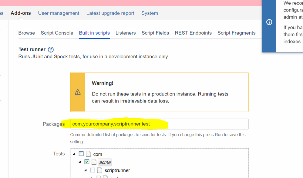

i suspect that i have to set the default package for the test, but i don't know where and how.

I was able to run tests from Idea when in field Packages (screenshot) in Jira package with tests was specified.  For example, if you tests are in com.yourcompany.scriptrunner.test, this package should be specified in Jira UI. It took a lot of my time to figure this out.  done.PNG
