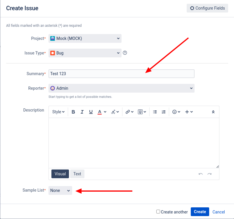

Below is a screenshot of the Server-Side Behaviour configuration for the Summary field:-

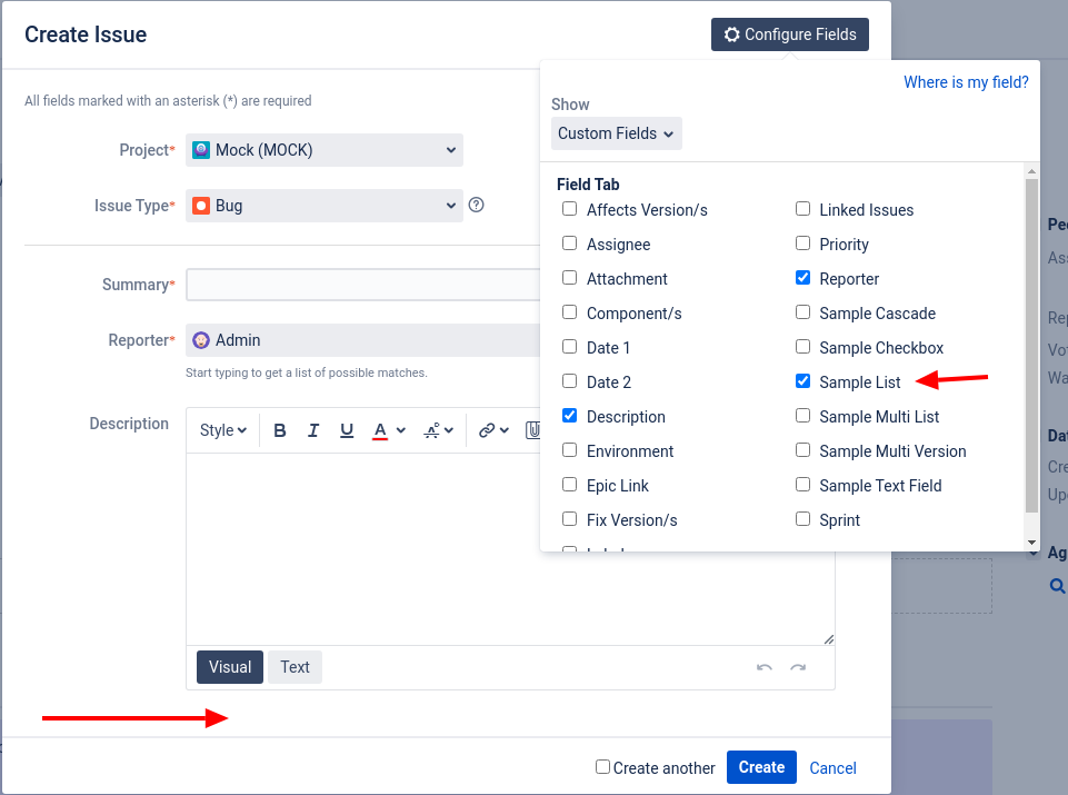

Below are a couple of test screenshots for your reference:-
1. By default, when the Create screen loads, the Sample List is hidden, as shown in the screenshot, because the Summary is empty, i.e. does not match the condition that has been set in the Behaviour
2. Once the Summary is updated to Test 123, i.e. it meets the condition set in the Server-Side Behaviour, the Sample List is visible and set to required.test2.png

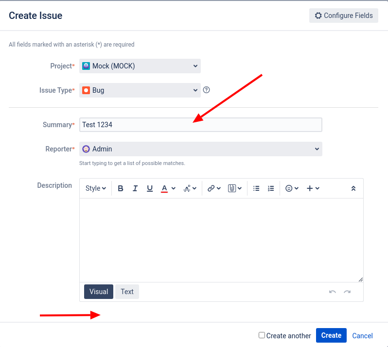

3. If the Summary is updated to something other than Test 123, as expected, the Sample List field is hidden and set to not required, as shown in the screenshot below:-test3.png
