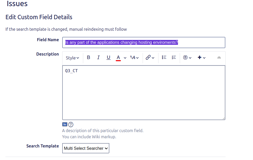

I have a few custom fields in Jira that also has a description. These descriptions are the keys i will be using to send data to my application for processing using ScriptRunner script.
The description of the field is there in the UI as shown below:
But when i try to retrieve this description using the api, it returns null. Upon revieweing the docs of api, i found that the description field is not there which is causing null value. Is there any other API that I could use to returrn the value of description field?

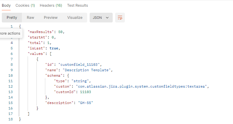

@Jamshaid
Try to use this endpoint: https://your-site.atlassian.net/rest/api/2/field/search?id=customfield_XXXX
You gonna have only field details and also your description. See the result example:
Just need to use and response body indentation to get the specific description content.
REST API Documentation: https://developer.atlassian.com/cloud/jira/platform/rest/v2/api-group-issue-fields/#api-rest-api-2-field-search-get
Hope this helps you :)
