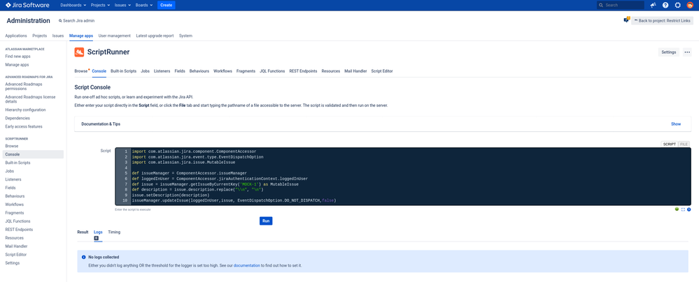

Below is a print screen of the ScriptRunner Console configuration:-

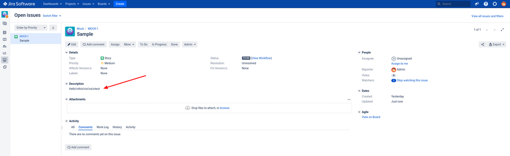

1) This is how the text in the Description field is displayed initially:-

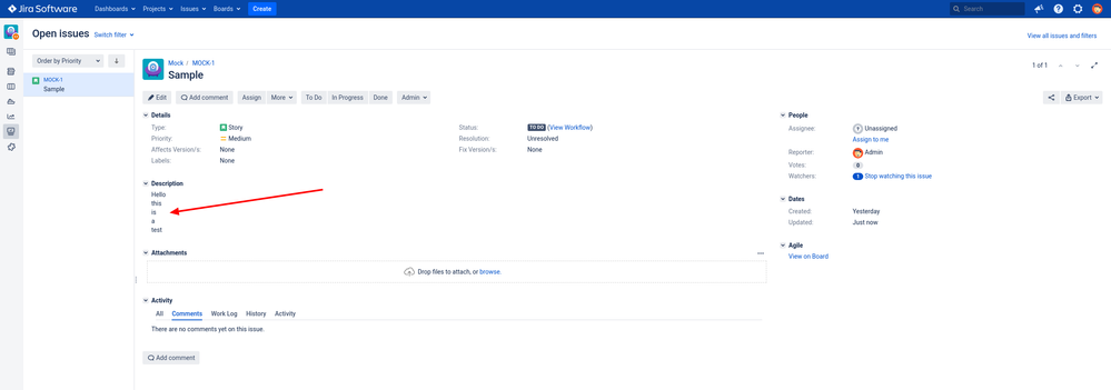

2) This is how the text in the Description field is after running the code above:-
