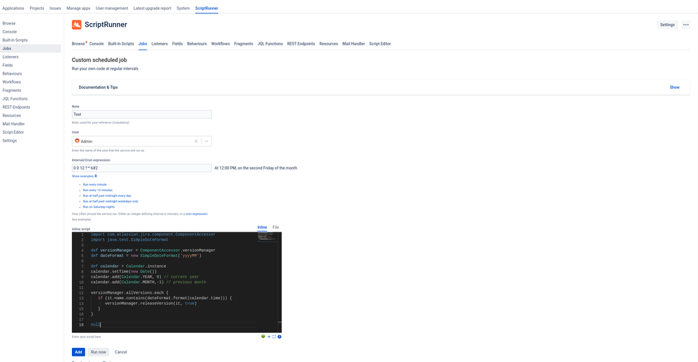

Below is a screenshot of the configuration:- image1.png
In the sample code above, the date range is set to one month before, i.e. the previous month.
If you intend to run this every month, I suggest that versions that are older than one month be run using the ScriptRunner console first.
Alternatively, if you want to run all of it using the Scheduled Jobs, you will need to configure multiple Scheduled Jobs according to the date range.
I hope this helps to answer your question. :)
