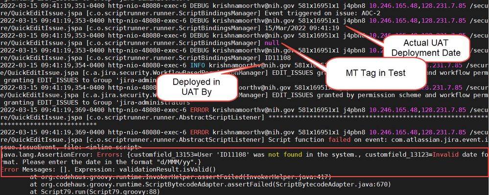

Venkat Krishnamoorthy
March 15, 2022
Here is what I see in the logs after adding your suggestion -
Here are field types for the custom fields -
Actual UAT Deployment Date - Date Picker field
MT Tag in Test - Text Field (Single line)
Deployed in Test By - User Picker field (Single user)
MT Deployment Tag - Text Field (Single line)
Thanks!
PD Sheehan
March 15, 2022
I had assumed that your date field was a date/time picker.
So change
def dateTimeFormat = 'dd/MMM/yyyy hh:mm:ss'
to
def dateTimeFormat = 'dd/MMM/yyyy'
And I always make the mistake between username and userkey, I never know which API works with which.
Change
 iip.addCustomFieldValue(cf4.idAsLong, currentUser.key)
To
 iip.addCustomFieldValue(cf4.idAsLong, currentUser.name)
March 16, 2022
Works now! Thank you very much.
