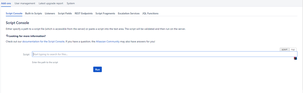

scriptrunner_scriptfile_location.PNGHi @Alexey Matveev, I don't see a help box that tells me the file path. Please see my screenshot above.
Edward Greathouse
October 22, 2018
@Alexey Matveev, nevermind! I followed the link you place on Feb 20.
 https://scriptrunner.adaptavist.com/5.3.6/jira/#_script_roots
I was able to see that when the Scriptrunner plugin was installed the directory called "scripts" was created under JIRA home.
Sorry to bother you and thank you for your assistance.
