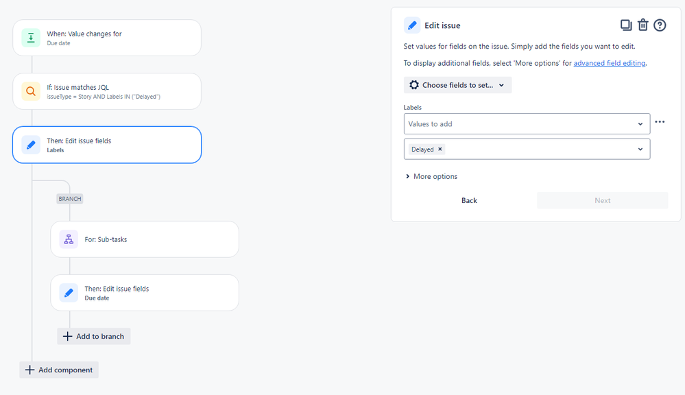

@andre to answer your question and provide you with a bit more certainty that it will move only the stories/sub-tasks within the epic, I've made a slight modification to the 2 automations I suggested.
This takes the form of adding a label 'Delayed' to each Story that is a child of the Epic when the Epic due date is changed, and yes to answer the second part of the change you would need to make the change to the due date on the Epic.
In the first automation the label is added to the child stories as well as updating the due date on the stories:
When setting the label in the automation you need select ADDREMOVE from the 3 dots to the right of the labels field:
For the second automation I've updated the IF condition to include looking for the label 'Delayed' (and removed the 'Delayed' label as part of the automation):

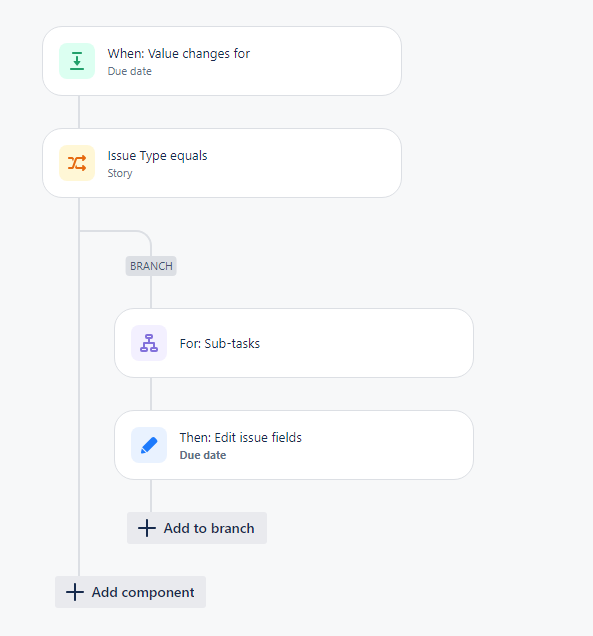

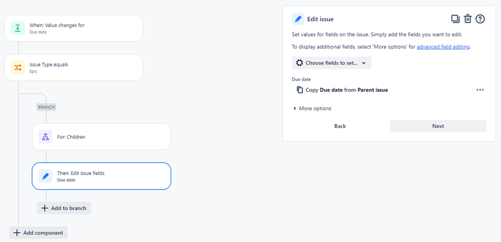

Hi @andre ,
I'm going to make the following assumption with this answer:
  • The due date for the epic, related stories and sub-tasks is going to be the same
The difference between @Aaron Pavez _ServiceRocket_ 's answer and mine is that I'm going to suggest using 2 automations and trigger them from updating the due date on the epic.
The first automation is to set the due date on the stories based on changes to the due date on the epic, so if my assumption above is correct all you will have to do is update the due date on the epic to a new due date and it will filter down to the child stories.
The second automation then looks for changes to stories and updates the due date for the sub-tasks:
It is important for the 2nd automation to make sure that the checkbox to allow the rule to be triggered by other automations is checked:

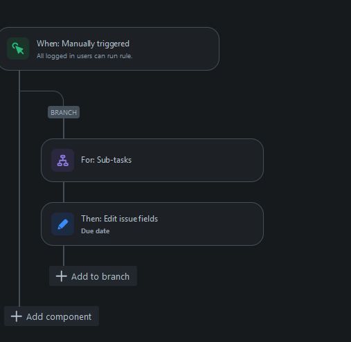

Hi @andre
You can do it with automation. Set the trigger as manual or scheduled. Since you do this when something is delayed, create a manual trigger to test it. You trigger this from the Story.
When: Manual
Branch : For subtasks
The edit : Due date : smart value {{now.PlusWeeks(2)}}
Screenshots
2024-10-22 14_49_40-Audit log - Automation - CaseSF - Jira — Mozilla Firefox.jpg2024-10-22 14_49_48-Audit log - Automation - CaseSF - Jira — Mozilla Firefox.jpg2024-10-22 14_50_01-Audit log - Automation - CaseSF - Jira — Mozilla Firefox.jpg
Hope that helps!
