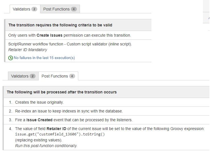

Rob B
February 1, 2018
Yes the same WF. Its a weird one the fact it works the first time, but then doesnt even though im doing exactly the same thing?
Below are the validators and post functions...
Neta Elyakim
February 1, 2018
1)Try to add logs to the script
2) Try this:
import com.atlassian.jira.component.ComponentAccessor
import com.opensymphony.workflow.InvalidInputException
def customFieldManager = ComponentAccessor.getCustomFieldManager();
def CustomFieldValue1 = issue.getCustomFieldValue(customFieldManager.getCustomFieldObjectByName("name1")) as String;
if
(CustomFieldValue1 == null && CustomFieldValue1=="") {
def CustomFieldValue2 = issue.getCustomFieldValue(customFieldManager.getCustomFieldObjectByName("name2")) as String;
if(CustomFieldValue2 == null && CustomFieldValue2 ==""){
invalidInputException = new InvalidInputException("name2 is mandatory when name1 is null");
If it's doesn't work I have no idea why it happens .. I use this script all the time on the create transition this way and did not come across it ..
By adding logs to the script you can know exactly why it's happen.
Rob B
February 1, 2018
Is there a chance it could be because one of the fields is a 'JSON Request Custom Field'?
