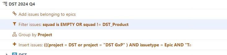

Would be very useful, if a line on the structure configurations could be activated / disactivated, so that I can make changes quickly, without needing to delete, and if I want to go back, need to create again.
As an example, I enclose a screenshot. In this case, would be useful that I could have the possibility to activate / disactivate the line that filters issuesjira-structre-lies.jpg

Hello @Marina_CL
Generators simply are not designed to work this way - they are either active(when the structure is opened by a user) or they remain idle(when the structure is closed).
If you want to be able to enable and disable particular filters, then you can use Filter transformations instead - these filters are only applied to the structure when turned on by a user.
