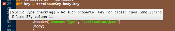

This error is a static type checking warning which indicates that the script does not understand the issue key and this may be due to the fact that you specified this before the post function which creates the issue meaning it may not be able to understand the issue key.
Could you please try using the example which I shared previosuly as this has been tested and contains no static type checking errors.
This example will create a new issue and link to it and is the recommend approach which we recomend using.
Could you please try the example we provided and if it solves your requirement accept this answer to mark it as correct for other users searching for a similar solution.

Alex Piwowar October 10, 2018
i see, the issue was that I didnt do .asObject(Map) for the create issue post.
The logs also threw an error about the outwardIssue not having a key so I changed id to key and it worked.
Thanks for the help!!!
I see that makes sense.
For some reason when I try to do
def createdIssueKey = createIssue.body.key
I get the attached error.
