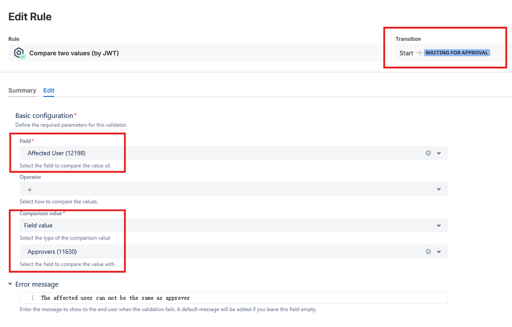

My idea is: In JSM, I have a request type that need user to input "affected user" and "Approver", I would like to restrict that the "affected user" can not be the same as  "Approver".  In workflow I use JWT compare two values validator.  The issue is when I enable this rule, I can not submit this request, if the "affected user" = "Approver", it will show the error message, it is OK.  But if the "affected user" != "Approver", it also can not submit this request, it will also show the error message.
Does anyone know how to fix this issue?

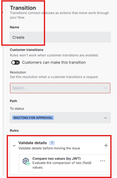

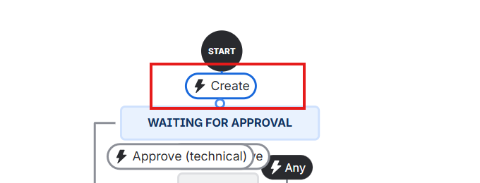

  • Could you please attach a screenshot showing where it's placed this specific transition in your workflow? Would be the first transition which is in the "Create" step?    Ben:  yes, you are right.  It is the first transition which is the "create" step.Screenshot 2026-05-11 103615.png

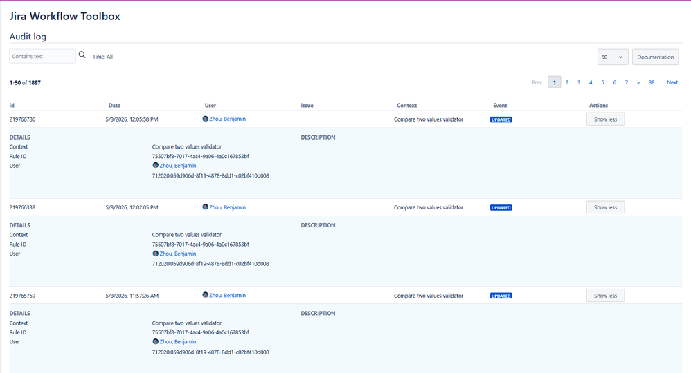

  • Does it appear any specific error in our Audit Log?   Ben: Please see the Audit log.Screenshot 2026-05-11 105113.png
