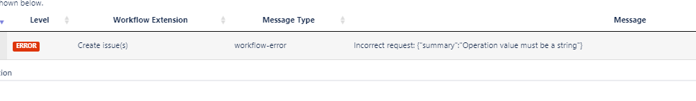

I'm using an iterator to generate a number of issues using JMWE. It appears to find all of the fields without fault except for the most important one, Summary. Attached are images of the errors and API response.

On the JMWE post function side i'm formatting summary like this:
{{it.fields.summary}}
I've also tried:
{{it.summary}}
and enabling the checkbox 'Iterator is formatted as JSON'.
Its strange as testing the iterator in JMWE appears to work fine and return all the fields of the tickets.
Any ideas?

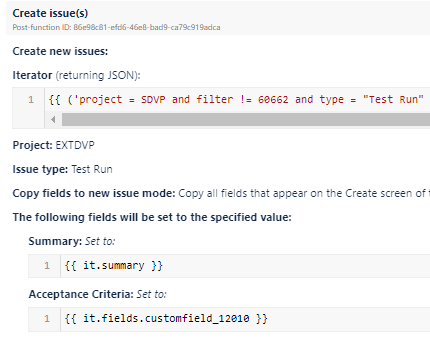

can you share the configuration of the post-function?

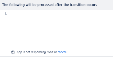

JMWE has been down most of today :/

Basically i have a 'Create issue' post function which iterates through a JQL. The JQL is based on existing child issues of the ticket that post function is run on. The post function maps a few fields manually but hasn't been able to find or populate Summary, though when testing in JMWE the data returns fine.
David Fischer
July 1, 2024
The error points to a configuration error, but without a screenshot of the actual configuration, i cannot see where the problem is.

What happens with
which is the correct syntax?
Also, can you share the full iterator code?
Ahmad Sidawi
July 1, 2024
@David Fischer
full iterator code:
{{ ('project = SDVP and filter != 60662 and type = "Test Run" and status not in (Obsolete, Passed, Failed, "Evaluation Only", Retest) and (parent = ' + issue.key + ' or "Epic Link" = '+issue.key+')') | searchIssues (maxResults = 20, startAt = 0) | dump(2) }}
it does return the issues when testing with all fields populated.
using
returns the same error.

Then it might be a regression in the app, related to the fact that you picked the "Copy all fields that appear on the Create screen" option.
