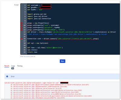

I can replicate the error you displayed, both in the console and in resources when I put a bad password:
2020-06-18 13_10_06-Script Console - https___projects-qsmdev.qad.com_plugins_servlet_scriptrunner_ad.png
But when I use the correct password, I'm able to connect using both methods.

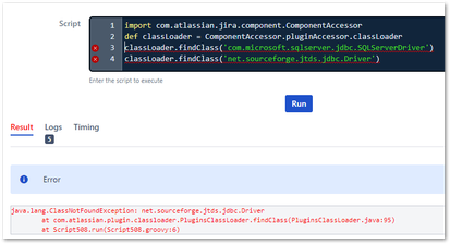

You can also use the console to test various classes to see which are actually available:
import com.atlassian.jira.component.ComponentAccessor
def classLoader = ComponentAccessor.pluginAccessor.classLoader
classLoader.findClass('com.microsoft.sqlserver.jdbc.SQLServerDriver')
classLoader.findClass('net.sourceforge.jtds.jdbc.Driver')
