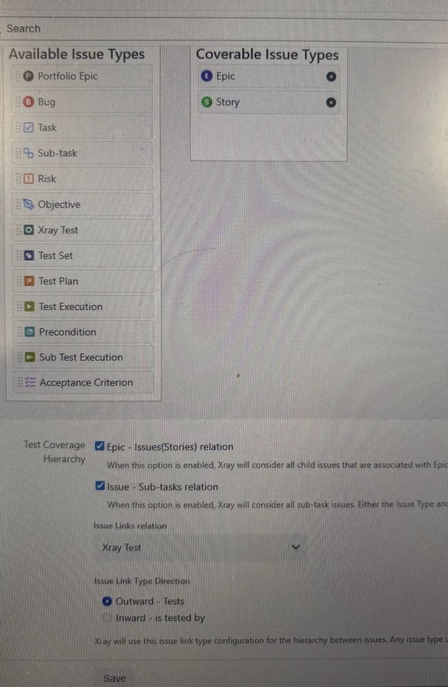

Hi, My test coverage section looks like below. I could see “Xray Test” for Issue Links relation section, but not “Test”. Am i in the correct section.

Does this mean i cant use the api since it looks for “Test” not anything else. Can i do any configuration change to make this work.
