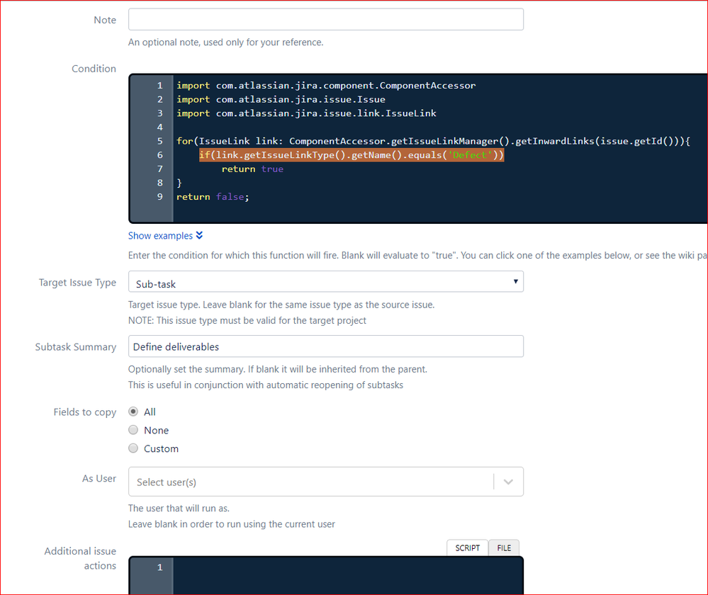

Luvo Kautah Ncibane
September 30, 2019
Hi @Sebastian Krzewiński
Thanks for your response but unfortunatelly it didnt help.
Luvo Kautah Ncibane
September 30, 2019
No luck still.

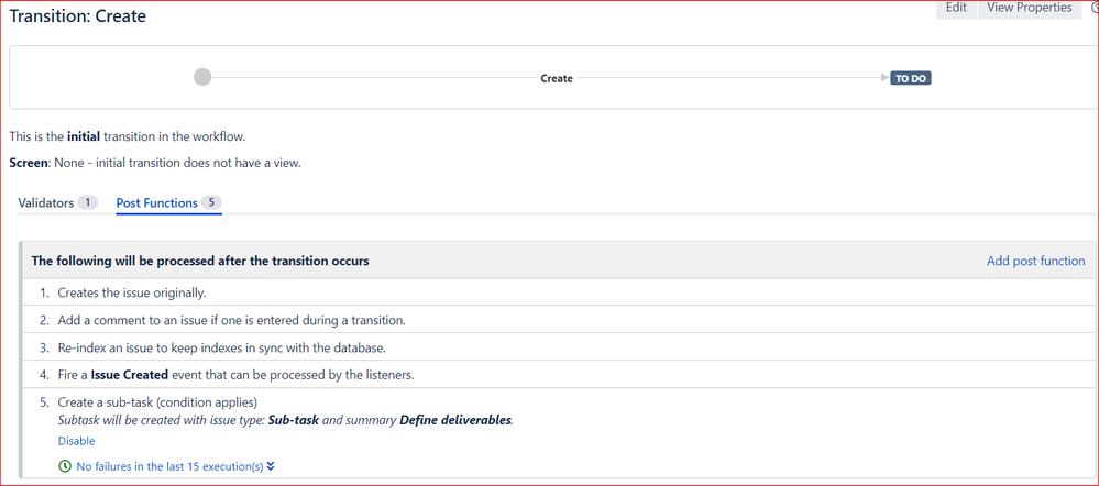

Luvo Kautah Ncibane
October 1, 2019
I have my post function in the create transition.

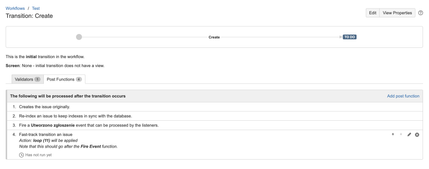

October 1, 2019
In cases like yours I make a "loop transition" and fire it usting fast-track transition.
In your case it will be loop from Todo to Todo. Then move Create subtask post function to loop transition. On Create transition add fast-track transition post function and mark that loop transitionn will be triggered without any condition.
Also you can hide loop transition from all users.

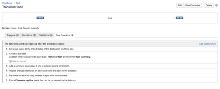

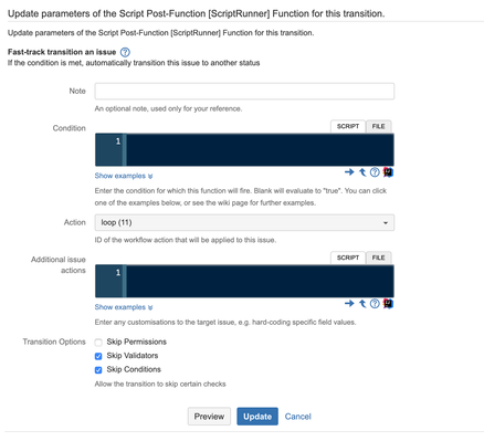

October 1, 2019
Sorry that my answer wasn't clear enough.
1. Workflow should look like this:
2. On create transition you add fast-track transition post function (without any condition)
3. On loop transition you add your subtask creation function
The reason that I do cases like this was because I saw that on create transition issue isn't be added to database with all needed information. So I must wait and run all needed function on second transition which is triggered from create transition.
From user perspective nothing is happend - issue after creation is in Todo status.
Regards,
Seba
