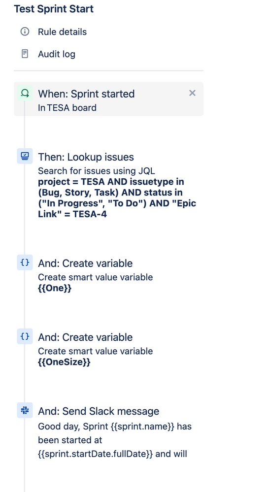

The reason why I have Look up + 2 variables creation, because I need multiple Lookups.

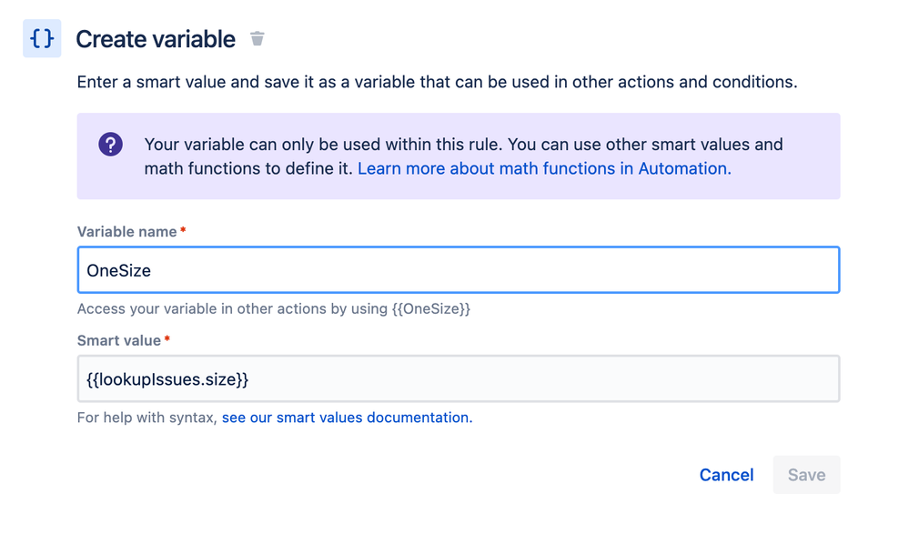

What I have for Variables creation, One: Screenshot 2022-09-18 at 19.34.28.png
And OneSize: Screenshot 2022-09-18 at 19.35.02.png

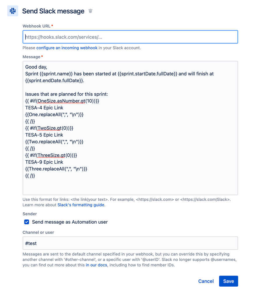

And Slack Message I need to compile:
So what I am doing here, I am creating 3 Lookups (you can see only One lookup+variables as I removed the rest for 1 specific showcase), after that I need to check the size of the lookup, if there is no issues within a specific epic link, then if condition should not run and the tickets + epic link summary should not show on the slack report.
So, I am building the One variable as the result of lookup formatting (which actually magically works), and building variable OneSize as size of the array (in my case it is 2, I have tested it). I have tried the asNumber stuff, but unfortunately, no matter what I do, this checkup gt(10) doesnt work. Each time it adds the section to the report, even number of tickets definitely lower than 10 (2<10 I believe).
So maybe even with just saving integer as 2 it works, with saving the lookup size it doesn't seem to work. Am I loosing some other magic here?
