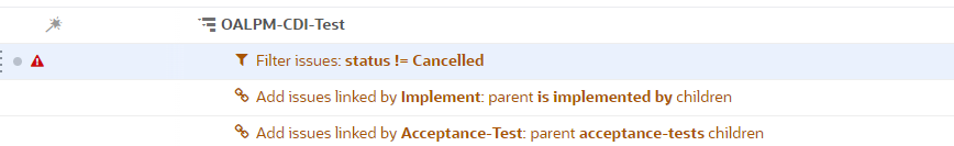

I have placed the filter at the very top..for your reference I have attached the structure Filter
Ramesh Kumar Srinivasan
August 26, 2024
@Dave MathijsI have placed the filter at the very top..for your reference I have attached the structure Filter
Dave Mathijs
August 26, 2024
@Ramesh Kumar Srinivasan Have you selected 'OALPM-CDI-Test' (in black) before adding the filter generator?
August 26, 2024
@Dave Mathijs 'OALPM-CDI-Test' (in black) is Jira Structure Name
Stepan Kholodov
August 26, 2024
Hello @Ramesh Kumar Srinivasan
As @Dave Mathijs already mentioned, the placement of a generator in the structure matters - you can get different results in different variations of it. Please try to add the Filter generator this way:
1. Click on the structure's name at the top right above the generators. The row of it would be highlighted in blue as a result.
2. Add the Filter generator. Generators are added under the focused item, so the Filter should be added at the very top of the structure.
I hope this helps. If you still get an error, please reach out to us directly at our support portal - we'll need to have a closer look at your setup to understand what takes place there.
Best regards,
Stepan
