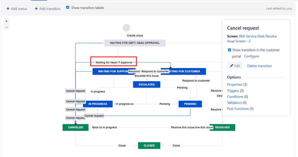

I already added a new transition "Waiting for IT Approval" between "Waiting for Dept. Head Approval and "Waiting for Support" state.
So, how can I set that transition to be another approval statement?
If you don't mind, could you please guide me, please?
Thank you

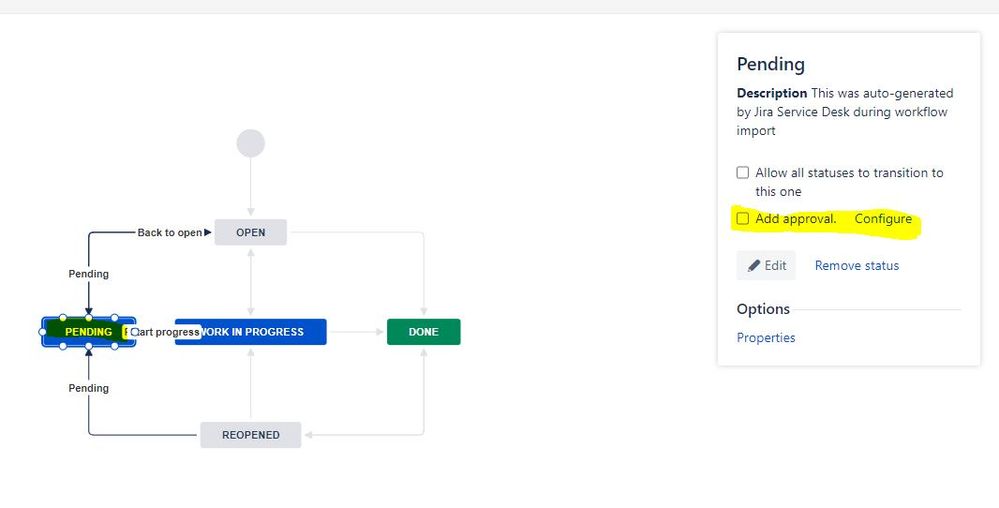

Hi @Dona Dianisya,
First, you will need to configure it on the status itself, not the transition:
Second, in order to be able to see and configure the approvals, you need to make sure the workflow is active on a Jira Service Management project.
I hope that helps answer your questions.
-Jimmy
