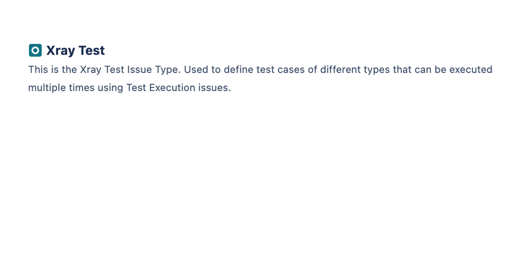

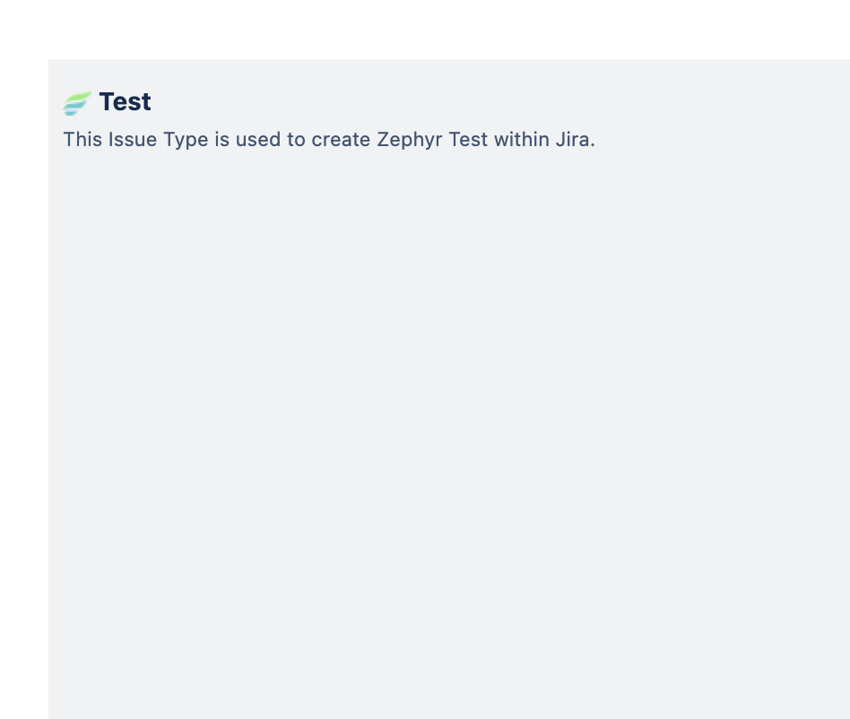

We have to identify Zephyr Test issue type uniquely when only Zephyr plugin is installed and enabled in Jira.
How we can achieve this ?
We have to identify XRay-Test issue type uniquely when only XRay plugin is installed and enabled in Jira.
We have to identify XRay-Test and Zephyr Test uniquely when both XRay and Zephyr plugin is installed and enabled in Jira.
We cannot use name, description of Issue Type as this can be editable by admin any time. We cannot use Issue Id also as this can change based on the instance.
