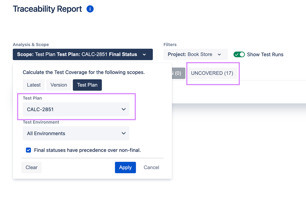

I can't get a traceability report generated in a way, to include only requirements covered in certain test plan.
I have nice set of test plans, each contains bunch of tests linked to a requirements tickets. Need to generate some .csv files, but only for some of the test plans I run this time, and need a way to somehow filter through them.
What I'm doing now is setting the scope to test plans, specifying the test plan, set no envt's (new test plans haven't got them assigned yet) and in the filters I'm just pointing at the project (every other filter just brings me 'no requirements found' message). Funniest thing is that results does not even include the one test plan I specified.
Is there any trick I can use to force xray to do what I want it to? Or a different way to get what I need (.csv file with results of all of the testing done in one or multiple specified test plans)?

If you need to generate a CSV for the traceability information considering the Tests in a Test Plan you can choose the analysis by test plan. Then on the quick filters select all coverage status, except the UNCOVERED one. That will only show the requirements that are covered by the tests of that the selected test plan.
Then you can export it to CSV. This works just one Test Plan.
