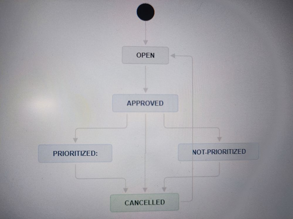

I have the same workflow in Parent Project (Initiative) and multiple Child Projects (Portfolio Epic) as below:

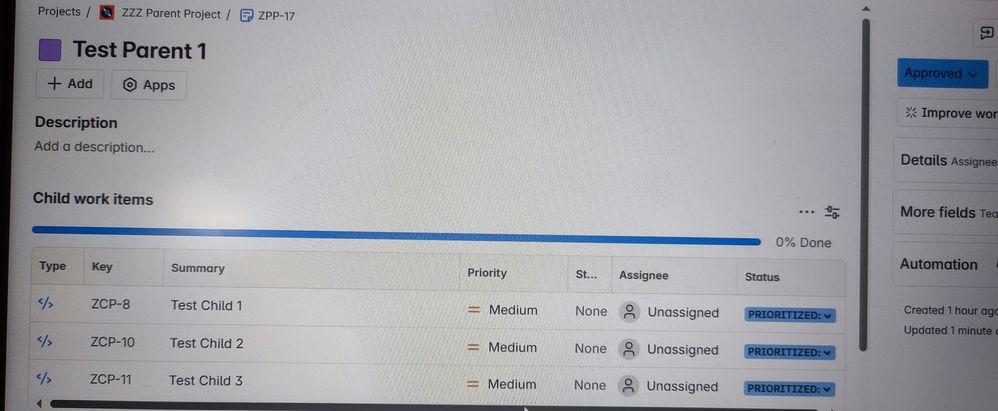

I tested one simple scenario where if all the children have moved to Prioritized, then only Parent should move to Prioritized by using this code on Move to Prioritized transition on Child Workflow:
{% set initiative = issue | initiative("key") %}
{% if initiative %}
    {% set children = initiative | membersOfInitiative("status") %}
    {% set allPrioritized = true %}
    {% for child in children %}
        {% if child.fields.status.name != "Prioritized:" %}
            {% set allPrioritized = false %}
        {% endif %}
    {% endfor %}
    {{ allPrioritized }}
{% else %}
    false
{% endif %}
But Parent status didn't change when all the children have been moved to Prioritized
Execution log is showing:
  • Message type: workflow-error
  • Message: Conditional Execution script does not look like a valid Nunjucks condition. Skipping execution.
Please guide further, and looking forward to hearing from you soon.
