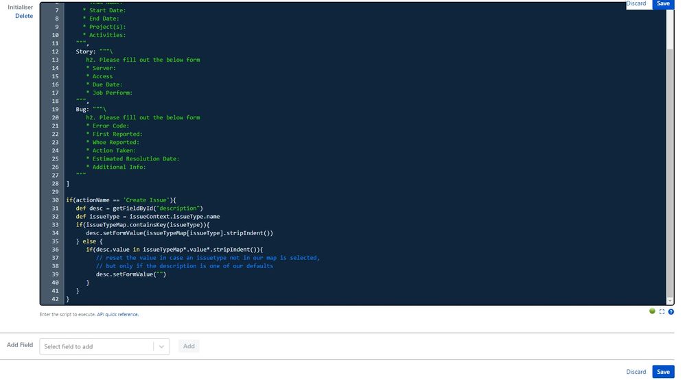

if(actionName == 'Create Issue'){
def desc = getFieldById("description")
def issueType = issueContext.issueType.name
if(issueTypeMap.containsKey(issueType)){
desc.setFormValue(issueTypeMap[issueType].stripIndent())
} else {
if(desc.value in issueTypeMap*.value*.stripIndent()){
// reset the value in case an issuetype not in our map is selected,
// but only if the description is one of our defaults
desc.setFormValue("")
Shah Baloch

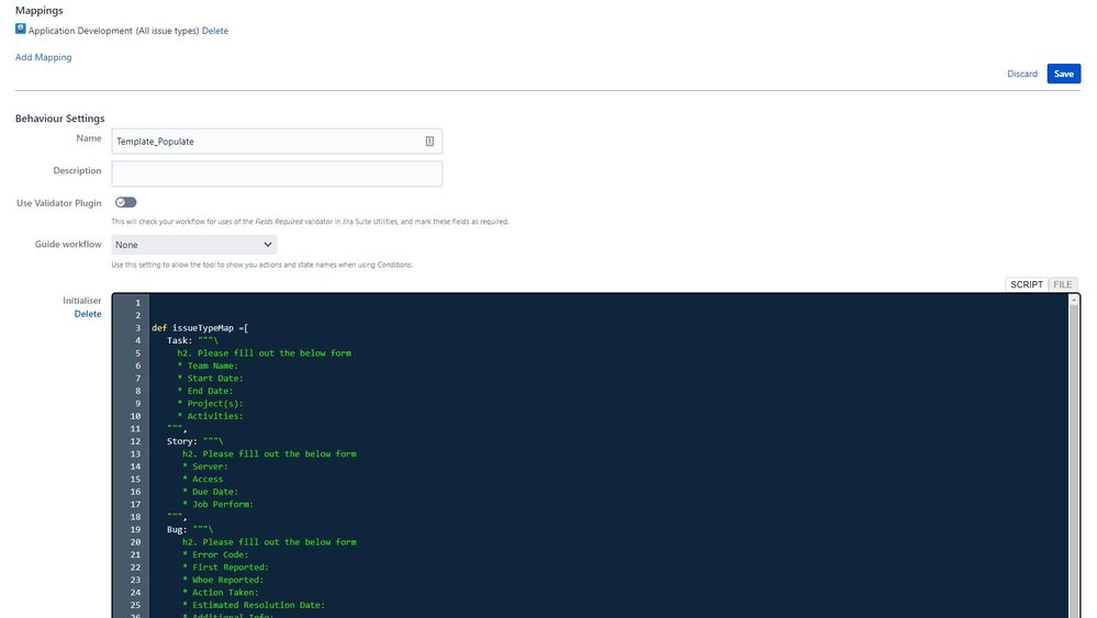

This needs to be in the "initializer" server-side script
The "description" server-side script only executes when the user changes the description field.

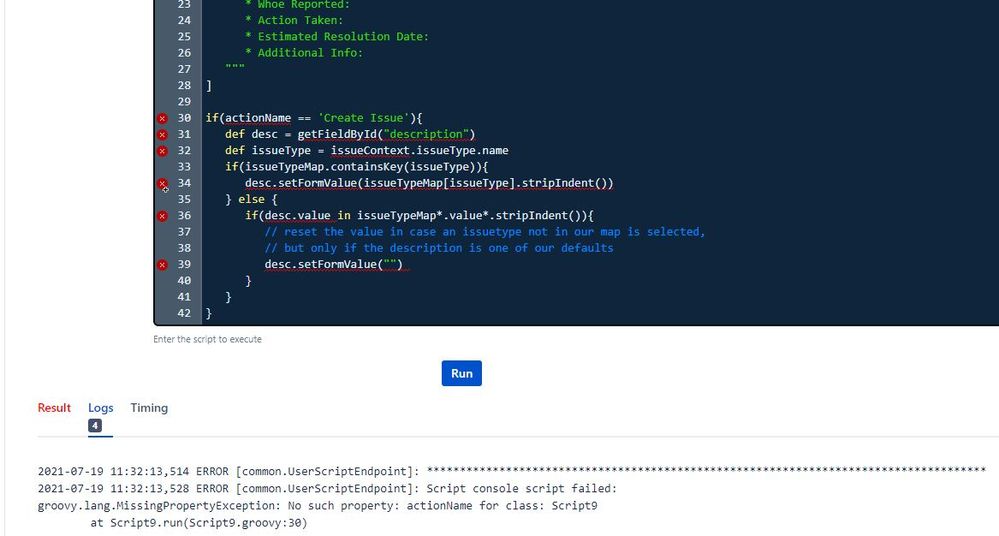

For some reason, it is not working. Maybe I am doing something wrong. I ran the code in the console and got some errors too. I'm attaching screenshots that might help. Thank you for your help.
PD Sheehan
July 19, 2021
Behaviour scripts can't run in the console. Methods like getFiedById(), getFieldByName(), getFieldChange(), getActionname() etc don't exist in the console.

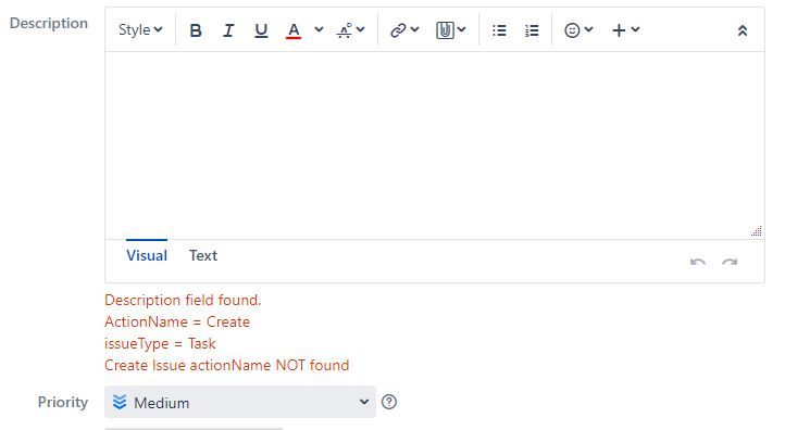

def debugText = "Description field found. <br>ActionName = $actionName<br>issueType = $issueType"
debugText += "<br>Create Issue actionName found"
debugText += "<br>Correct issueType was found. Setting default desc value"
} else {
debugText += "<br>Incorrect issueType was found. Test if we can reset the desc"
debugText += "<br>Current description matches a template. Resetting to blank"
} else {
debugText += "<br>Current description doesn't match a template. Leave it as is (user input)"
} else {
debugText += "<br>Create Issue actionName NOT found"
desc.setHelpText(debugText)
 If you don't see any red help text under the description field, then you will need to look at the atlassian-jira.log file under your jira installation directory. There may be additional clues.
Shah Baloch
July 19, 2021
@PD SheehanI am seen create issue not found below the description field. The screenshot is attached. Thank you
PD Sheehan
July 19, 2021
Ok, then change this line:
to
if(actionName == 'Create'){
Not sure why I assumed the actionName would be "Create Issue" ... even in my own code, I use "Create" when checking which actionName to execute some behaviour script against.
