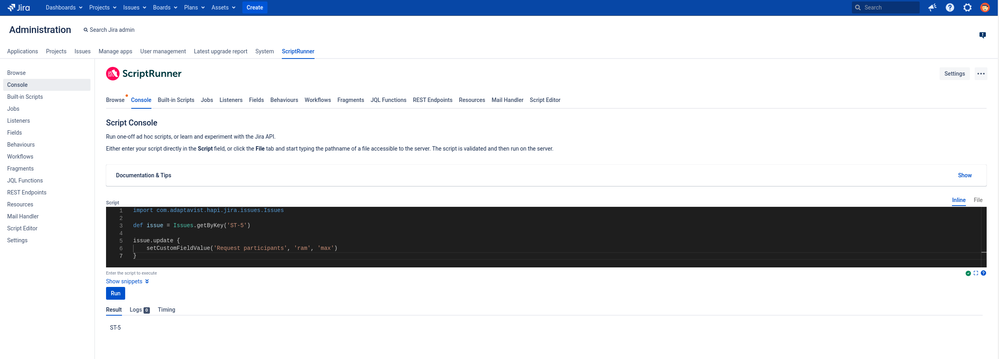

I am running the sample code using the ScriptRunner console.
Below are a couple of test screenshots for your reference:-

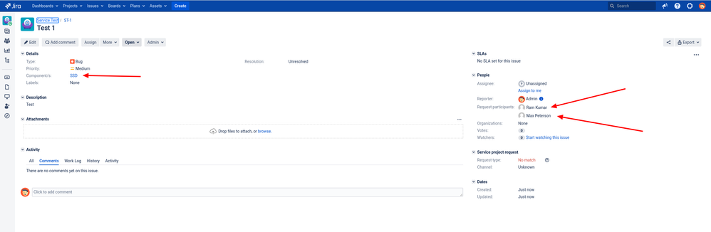

1. Below is the example ticket
2. I added the sample code to the ScriptRunner console and executed it as shown below:-
3. As expected the Request participants is added as shown below:-

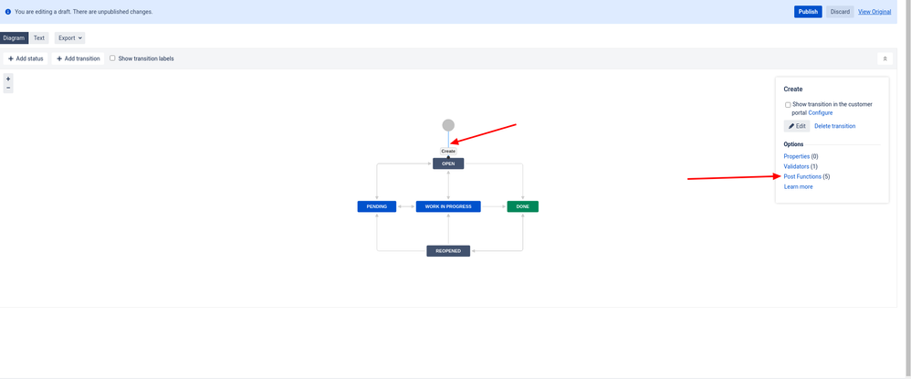

1. Use the create transition and select the Post-Function

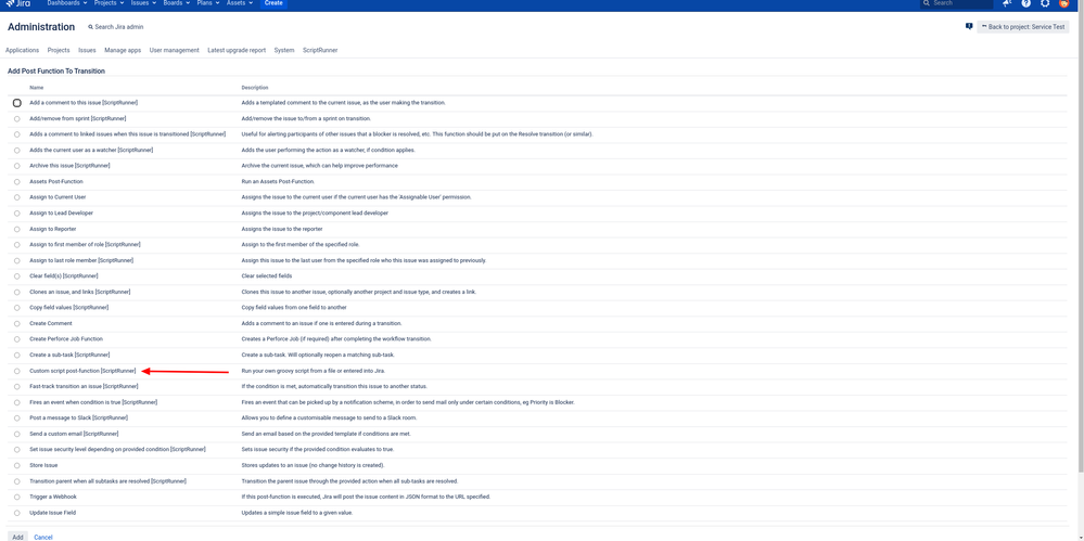

2. From the Post-Function options, select ScriptRunner's Custom script post-function

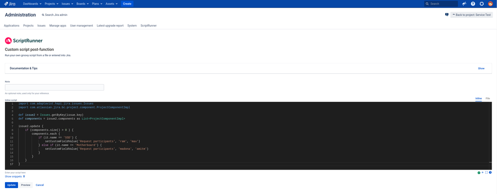

3. Add the sample code provided as shown below:-

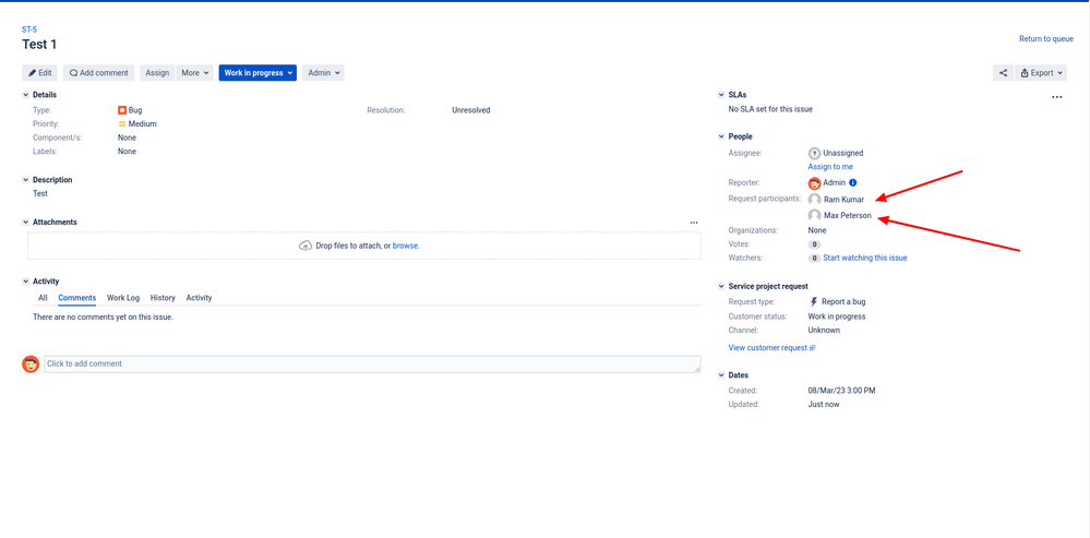

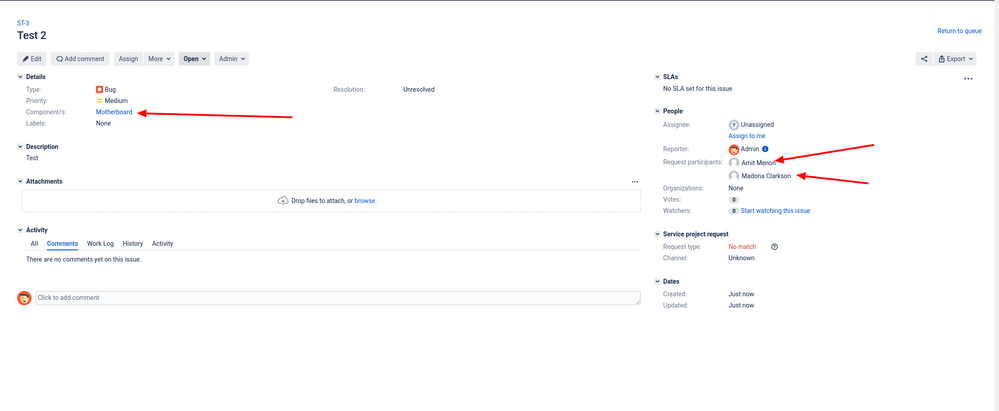

Below are a couple of test screenshots:-
1. Create a new issue and set the component to SSD
2. Once the Issue is created as expected, the Request Participants are set to Ram Kumar and Max

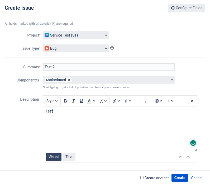

3. Create a new issue and set the Components to Motherboard.
4. As expected, the Request Participants are set to Ajit and Madona.
