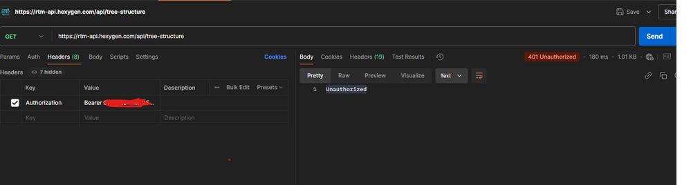

Hi ,
the idea is a great if I can work with it,
but always when try to hit endpoint you have provided above, I have received 401 while I have pass TOKEN with different ways through Headers or Auth
look at SS attached please if you can help me

Humashankar VJ
November 11, 2024
@Abdullah Younis
The 401 error you're encountering indicates an unauthorized access attempt, likely due to incorrect authentication. To resolve this issue, follow these troubleshooting steps.
  • First, verify that you're using a valid API token, which is distinct from your Jira password. If necessary, generate a new token by visiting ( https://id.atlassian.com/manage/api-tokens), clicking "Create API token," and copying the token immediately.
  • Next, ensure you're using Basic Authentication with your email and API token. The Authorization header should resemble
  • Authorization: Basic <base64-encoded-credentials>," where <base64-encoded-credentials> is the Base64 encoding of your-email@(Authorization: Basic <base64-encoded-credentials>)your-api-token.
Furthermore, confirm you're using the correct API endpoint. Note that the RTM API is separate from the standard Jira API. Unfortunately, the RTM app's public API documentation is limited.
The RTM app does have a REST API, although its scope may be restricted. The endpoint structure is not publicly documented but is likely similar to https://<your-jira-instance> (https://<your-jira-instance>.atlassian.net/rest/rtm/1.0/). The API should enable basic operations on RTM objects like requirements, test cases, and folders.
