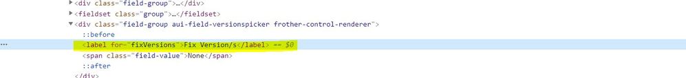

There are different ways to identify the field id. I personally like to just examine the page html using the browser developer tools. Open the form with the field you want to hide, right-click on the field and select inspect.
For example, doing that on the fix version, you will see something like this:
2021-03-25 09_14_48-DevTools - projects.qad.com_secure_RapidBoard.jspa_rapidView=1124&quickFilter=73.png
I have highlighted where I found the field ID.

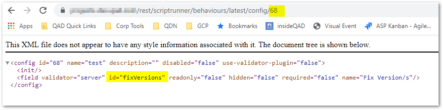

You can also use the form-base configuration, add the field and save, then examine the behaviour rest output:
<baseUrl>/rest/scriptrunner/behaviours/latest/config/<id>
 It will show you the fields you selected and their ids

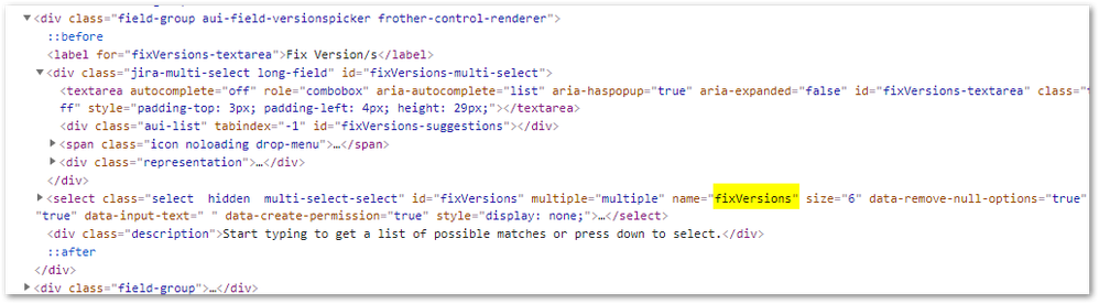

fixversion.JPGhey @PD Sheehan There is no error as such, but somehow its not working. I just noticed that upon clinking inspect, Fix Version field is not showing field ID like yours, for other fields it does show to me as well.
PD Sheehan
March 30, 2021
Probably a difference in jira version or version field display configuration difference.
Try this:
In behaviours, add the fixVersion Field and save your behaviour.
Look at the URL
Now, change the plugins/sevlet/scriptrunner/admin/behaviours/edit part of the URL with wih rest/scriptrunner/behaviour/latest/config
This will show you exactly what your field ID is.
If your script still doesn't work with that id, you'll have to share your full script for debugging.
