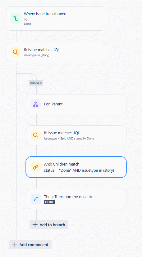

Hi @Heba Hasan
The automation below should do what you want, with the exception that I don't have Technical Story set up as an issue type so you'll need to update the JQL in steps 4 and 5, and you could remove the check for epic status in step 4 (in fact if you're hierarchy is set up so that stories and tech stories are always under an epic you don't need step 4 at all):

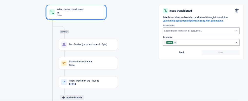

Pasam Venkateshwarrao
March 24, 2025
Hi @Heba Hasan
Welcome to the community, i have attached the Automation rule as similar which you are looking
Hope this helps
Stephen_Lugton
March 25, 2025
Hi @Pasam Venkateshwarrao
This automation would work for setting child stories, etc. in an epic to Done when the epic was set to Done instead of setting the epic to Done when all of the stories or tech stories are set to Done, but you would have to be sure that your workflow allows issues to transition to Done from all statuses for it to work as expected.
