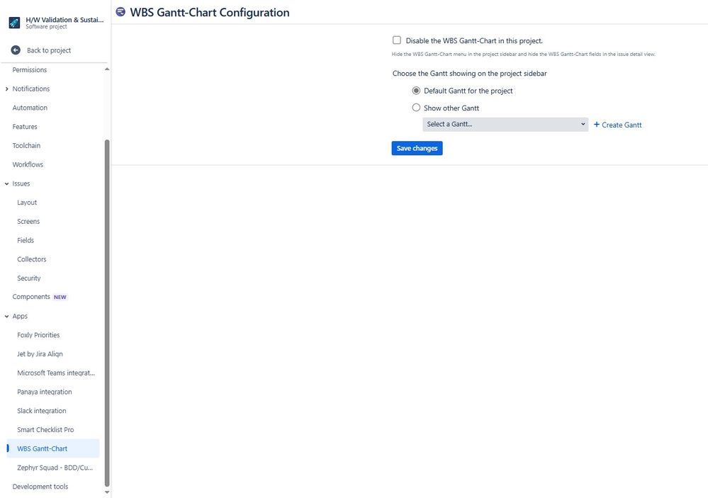

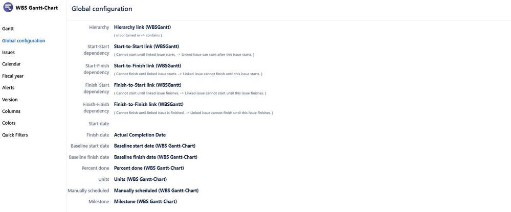

Hello Charlotte, Many thanks for your answer. I am on the cloud app and I have not the same admin page as yours and my admin rights are limited. You can check the picture attached the Start date fiels is empty in my config and the Finish date says: Actual completion date. but I cannot edit any of these fields.WBS Gantt-Chart config.jpg

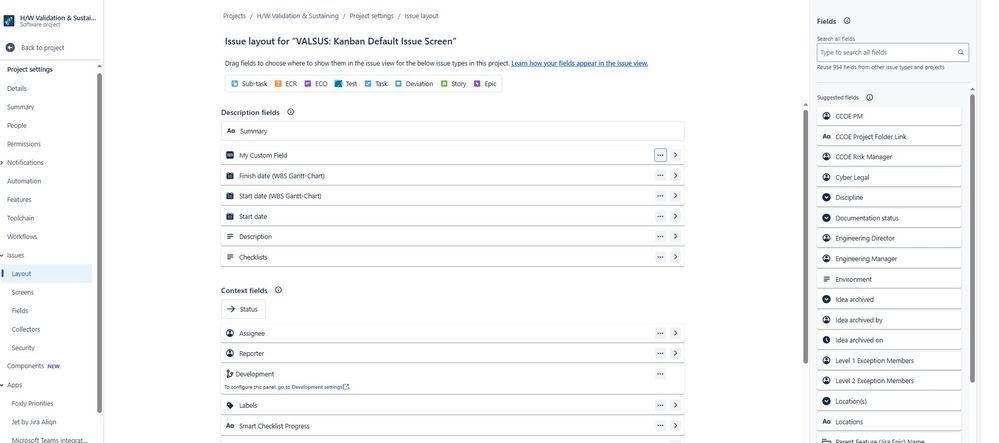

And on the JIRA side I only have access to the below pictureWBS Gantt-Chart JIRAsettings.jpg
And I know start date and finish date are configured in all my issues. It was working nicely last week :)
